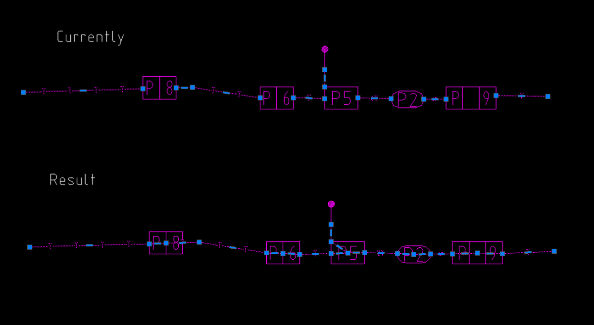

Hi All,
Does anyone know of lisp that can assist of connecting polylines to geometric centre of blocks? I need to do this on large number of drawings to acheive the connection of the polyline to the centre of the block, basically adding a vertex that connects to the centre of the block. example dwg attached
Test to centre of blocks.dwg

Thank you Steven. I think I saw this in a forum with you & @JuniorNogueira  a while back when i was searching the web for something to achieve this. I will test this out but it looks like just brings the centre text coords of a rectangle?:
I have 19 to 20 different blocks, in the example attached I have put most commonly used which is 5 blocks. I have scourged Lee Macs lisps, credit to @Lee Mac. The closest I could find was what does the exact opposite of what I am trying to achieve which is http://lee-mac.com/autoblockbreak.html
Also another important thing to note that my blocks are dynamic blocks in the test dwg not standard blocks.

I have tried some code at the beginning that connects polylines at insertion point of a block, but then remembered mapclean tools;
Therefore, I found a way to do this if you are interested using MAP3D tools mapclean without the need of a lisp, the result is as follows though
Snap to clustered Nodes feature
However the part I am missing is creating the extra vertex rather than extending the existing endpoint to the insertion point.
Hope this helps someone out there with my same issue as well.

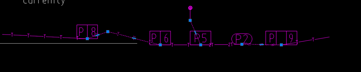

Hi exceed,
This is brilliant!  Is there a small adjustment if I want the vertex to snap to the insertion point instead of the Block centre?
I will give a try and get back to you! You are amazing mate
Don't worry about it if it is too much hassle im still happy and very grateful for this!
Edited by cadggnore

6 minutes ago, exceed said:
; CONNECT - 2022.05.27 exceed
; https://www.cadtutor.net/forum/topic/75205-lisp-to-connect-polylines-to-centre-or-centroid-of-blocks/
; Connect the polyline connected to the border of the block by extending it to the center point of the block.
; Command List
;   CONNECT - Connect to Insertion Point
;   CONNECT2 - Connect to Center Point
; To avoid errors, only fix if the polyline's first point or endpoint is inside the block. = It does not modify when passing or passing through a block.
(vl-load-com)
(defun c:CONNECT ( / basept )
  (setq basept "InsertionPoint")
  (ex:CONNECT basept)
(defun c:CONNECT2 ( / basept )
  (setq basept "CenterPoint")
  (ex:CONNECT basept)
(defun ex:CONNECT ( basept / ssb ssbl ssbindex 1blk 1blkobj pt1 pt2 midpt ssp sspl sspindex 1pl 1plobj 1plcoord 1plstartpt 1plcoordlen 1plendpt newcoord1 newcoord2 )
  (setq ssb (ssget ":L" '((0 . "INSERT"))))
  (setq ssbl (sslength ssb))
  (setq ssbindex 0)
  (repeat ssbl
    (setq 1blk (ssname ssb ssbindex))
    (setq 1blkobj (vlax-ename->vla-object 1blk))
    (vla-getboundingbox 1blkobj 'MinPt 'MaxPt)
    (setq pt1 (vlax-safearray->list MinPt))
    (setq pt1 (list (car pt1) (cadr pt1)))
    (setq pt2 (vlax-safearray->list MaxPt))
    (setq pt2 (list (car pt2) (cadr pt2)))
    (cond
      ((= basept "InsertionPoint")
        (setq midpt (vlax-safearray->list (vlax-variant-value (vlax-get-property 1blkobj 'InsertionPoint))))
      ((= basept "CenterPoint")
        (setq midpt (list (/ (+ (car pt1) (car pt2)) 2) (/ (+ (cadr pt1) (cadr pt2)) 2) ))
    ;(princ midpt)
    (setq ssp (ssget "C" pt1 pt2 '((0 . "LWPOLYLINE"))))
    (setq sspl (sslength ssp))
    (setq sspindex 0)
    (repeat sspl
      (setq 1pl (ssname ssp sspindex))
      (setq 1plobj (vlax-ename->vla-object 1pl))
      (setq 1plcoord (vlax-safearray->list (vlax-variant-value (vlax-get-property 1plobj 'Coordinates))))
      ;(princ 1plcoord)
      (setq 1plstartpt (list (car 1plcoord) (cadr 1plcoord)))
      (setq 1plcoordlen (length 1plcoord))
      (setq 1plendpt (list (nth (- 1plcoordlen 2) 1plcoord) (last 1plcoord)))
      (setq newcoord1 '())
      ; case for startpoint
      (cond
        ((and (and (>= (car 1plstartpt) (car pt1)) (<= (car 1plstartpt) (car pt2))) (and (>= (cadr 1plstartpt) (cadr pt1)) (<= (cadr 1plstartpt) (cadr pt2))))
          ;(princ "\n 1pl startpt - ")
          ;(princ 1plstartpt)
          (setq newcoord1 (cons (cadr midpt) 1plcoord))
          (setq newcoord1 (cons (car midpt) newcoord1))
          (vlax-put 1plobj 'coordinates newcoord1)
          (setq 1plcoord newcoord1)
      (setq newcoord2 '())
      ; case for endpoint
      (cond
        ((and (and (>= (car 1plendpt) (car pt1)) (<= (car 1plendpt) (car pt2))) (and (>= (cadr 1plendpt) (cadr pt1)) (<= (cadr 1plendpt) (cadr pt2))))
          ;(princ " / 1pl endpt - ")
          ;(princ 1plendpt)
          (setq 1plcoord (reverse 1plcoord))
          (setq newcoord2 (cons (car midpt) 1plcoord))
          (setq newcoord2 (cons (cadr midpt) newcoord2))
          (setq newcoord2 (reverse newcoord2))
          (vlax-put 1plobj 'coordinates newcoord2)
      (setq sspindex (+ sspindex 1))
  (setq ssbindex (+ ssbindex 1))
you can use both option now
Brilliant mate! Love your work. This works perfectly
