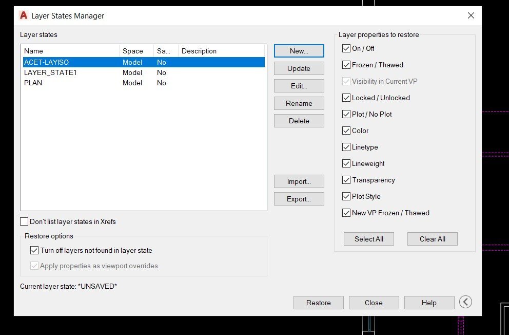

Sorry that it didn't help. I don't use layer states that much and so far never in a viewport. What does your layer states manager window look like? Maybe a setting there?

There are no viewport overrides on the Model tab! Any layer you freeze on the Model tab is frozen everywhere. That's how it's supposed to work. If you freeze (Not VPfreeze) a layer in a viewport it would be frozen everywhere in the drawing as well.

You can create as many layer states as you need. If you have two viewports in your layout, you can create a layer state for each one to display different layers in each viewport. But, if you go into model space and start freezing layers, as tombu mentioned, that will affect your viewport display when you go back to your layout and those layers that you froze in model space will no longer be visible in your viewports. I believe this is the problem you are describing. Once you create your layer states, it's best to leave model space alone. Just work inside your viewports.

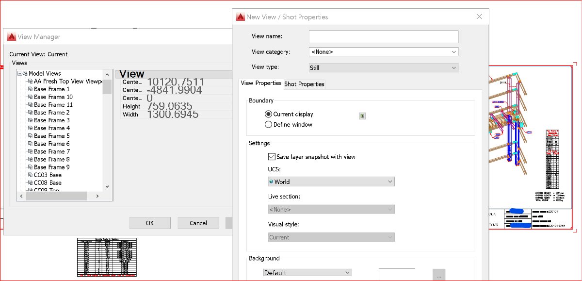

I have never used LT, so not sure, but in Vanilla Autocad I use the VIEW command to do this.
The View Manager Dialog Box will open.
Double click inside a particular viewport for which you want to do it.
Select NEW  >  Create a Name  >
Confirm that Save a Layer Snapshot is checked
Click OK to exit the dialog box.
Later if you are inside an Active viewport you can use the VIEW command to reaccess that list.
Choose the Name that you want to restore, and   SET CURRENT  >
OK  >
On the Layer States Manager you will need to highlight by selectine the View you want to see  >
RESTORE  by hitting that option at the bottom of the dialog box.
