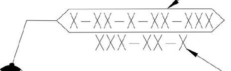

Hi All,
I've been asked to put a hexagonal frame around the text in some leaders (see image), but I have no idea how to achieve this.  I noticed there's an option in the properties to add a frame, but it makes it just square.
Any help on how to achieve this hexagon look on the text frame would be greatly appreciated!

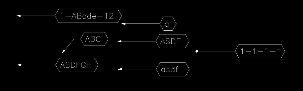

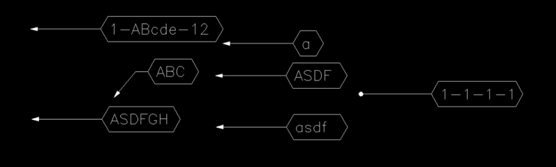

I had another look taking your dynamic block as is no scaling etc that may be needed also down the track.
The Distance 2 would be 3.5 * number of characters in text. The sequence is ask for text, insert dynamic block, then up date distance 2.

I like the idea of this so looking at this again part 2 is change text and the box changes size.
The other enhancement is leader left or right at moment just right and pick points and  last is various shapes say arc on ends. These would be visibility states.
Happy to do more but need dynamic block changed, something I am still learning. Need 1 attribute in all visibility states not sure how to do that.
