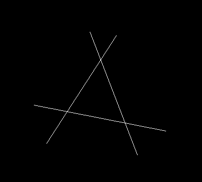

hamadmirza Posted June 16 Share Posted June 16 Hi, everyone. I am looking for a lisp command which can do the following. 1- Calculate area of enclosed area, the lines are not joint, but they are making enclosed area. When I click in side that area it should detect the lines and calculate area. 2- Then it should place an Alphabet their inside the enclosed area in capital form, when all 26 letters are placed it should go on with AA, AB, AC so on and so forth. 3- After clicking inside area and calculating the area, User should be able to place the label (value) by clicking in the cell of an already placed table as Field along with the Alphabet in the adjacent cell. I am also thinking of other tools which can help in increasing the efficiency of my work. Looking forward for positive replies from this forum. thanks Quote Link to comment Share on other sites More sharing options...

psychopomp1 Posted June 17 Share Posted June 17 12 hours ago, hamadmirza said: 1- Calculate area of enclosed area, the lines are not joint, but they are making enclosed area. When I click in side that area it should detect the lines and calculate area. This doesn't make much sense. If the area is enclosed then the lines MUST be joined together, otherwise it can't be called an enclosed area. But to answer your question, in AutoCAD simply select the polygon and type 'list' in command line and Bob's Yer Uncle Quote Link to comment Share on other sites More sharing options...
mhupp Posted June 17 Share Posted June 17 (edited) 1 hour ago, psychopomp1 said: This doesn't make much sense. If the area is enclosed then the lines MUST be joined together, otherwise it can't be called an enclosed area. I guess they are talking about something like this. lines that cross but wouldn't make a polyline if you used the join command. Edited June 17 by mhupp Quote Link to comment Share on other sites More sharing options...
tombu Posted June 17 Share Posted June 17 Why not use the Lee Mac lisp f700es posted for labeling the areas then use TCOUNT (Express Tool) to add letters as a prefix or suffix to the areas? Quote Link to comment Share on other sites More sharing options...
hamadmirza Posted June 17 Author Share Posted June 17 10 hours ago, psychopomp1 said: This doesn't make much sense. If the area is enclosed then the lines MUST be joined together, otherwise it can't be called an enclosed area. But to answer your question, in AutoCAD simply select the polygon and type 'list' in command line and Bob's Yer Uncle By joint I meant it is not a region or polyline or rectangle. Each line is separate entity, like lines are. Majority of the tools first ask to convert or create joint entities like rec or region to give area. I have large and complex drawings . So going on and creating each area lines into those entities or calculating them takes a lot of time. Also have tried many other methods which really are not that helpful. So came up with this message so that if I can find any such lisp or tools then it would save a ton of time. I hope this clarifies things a bit. Quote Link to comment Share on other sites More sharing options...

BIGAL Posted June 18 Share Posted June 18 I thought I posted a comment, like tombu's image you can use BPOLY to make a boundary inside a closed shape. A slight different approach 2 stages just pick inside each area and label A,B C etc then ssget all these text loop through and do bpoly based on insertion point of text and get area. Either keep bpoly or erase. I know I have done this method just quickly put this together to show how. If you Google there is code for A-Z then AA -AZ etc. (defun c:test ( / lay ss txt txtstr txtins bp parea) (setq lay (cdr (assoc 8 (entget (car (entsel "\nPick a text for layer ")))))) (setq ss (ssget "X" (list (cons 0 "*text")(cons 8 lay)))) (repeat (setq x (sslength ss)) (setq txt (vlax-ename->vla-object (ssname ss (setq x (- x 1))))) (setq txtstr (vla-get-textstring txt)) (setq txtins (vlax-safearray->list (vlax-variant-value (vla-get-insertionpoint txt)))) (command "bpoly" txtins "") (setq bp (entlast)) (setq parea (vla-get-area (vlax-ename->vla-object bp))) (command "erase" bp "") (princ (strcat "\nArea = " (rtos parea 2 3) " ID " txtstr)) ) (princ) ) Quote Link to comment Share on other sites More sharing options...
Steven P Posted June 21 Share Posted June 21 (edited) Looking at this in parts, not sure how stuck you are with this you see, but be patient with me. So objective 1, getting the area and a slightly unusual method I think based on an answer to another question, using '-Hatch' and picking an internal point: Here you select a point enclosed by lines, polylines, circles, etc so long as the area is completely enclosed. Lines can be at different elevations I think. Exactly the same rules as if you were creating a hatch. You also need to see some of border for the area you want to calculate. (defun c:getarea ( / MyPt eo areA) (setq MyPt (getpoint "Select Internal Point")) (command "-hatch" MyPt "") (setq obj (vlax-ename->vla-object (entlast))) (setq area (vlax-get obj 'Area)) (entdel (entlast)) ;;;;;;;;;;;;;;;;;;;;;;;;;;;;; ;;The above gets the area (as variable area, I'm a simple man) and a point (MyPt, nearly as obvious, that's a complex as I want to be) ;;Use the variable area as you want, here it is writng that to the point you selected initially, MyPt (command "text" MyPt "" "" (strcat "Area = " (rtos area 2 2) " sq. units") "") ;;And here it is writing the area identifier, for example 'A' in this case (setq MyPt (mapcar '+ '(0 5 0) MyPt)) (command "text" MyPt "" "" "A" "") (princ) ) Used in a loop you could ask the user to enter or select the most recently used reference text (A, B, AA, AB, or whatever), increment that by 1, ask the user to select a point in the area and then loop to select a point in the next area saving or select the table cells and then loop as your preference might be. I would prefer to select all the areas, save their areas into a list and label them before going to the table to complete that. For the next stage, have you got an example table you would use that could be used to check out populating what you want and how? Edited June 22 by Steven P 1 Quote Link to comment Share on other sites More sharing options...
