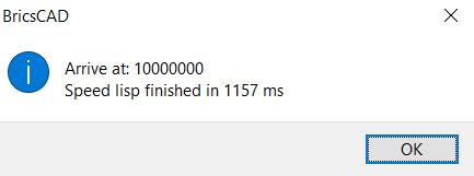

Edison CB Posted June 22 Share Posted June 22 Good morning friends, could someone help me with the following problem: i have a code that i run in the Lisp IDE, code that deals with matrix analysis, additions, subtractions, replacement of row and column values and even inverses of those matrices; which takes about 10 seconds, but when i run the code once the .lsp is loaded i run the same operations from the command line and the operations are performed in 90 to 100 seconds, does anyone know why that happens and how i could fix it, thanks for your answers. Quote Link to comment Share on other sites More sharing options...

Edison CB Posted June 22 Author Share Posted June 22 Good morning friends, thanks for the answer, i do not place the code because the problem occurs only in a part of the whole project, also this part of the code pulls data from other sub routines, and it is complex to place it here, but instead i put this code to test what i mention: (defun c:speed () (setq i 0) (setq n 10000000) (repeat n (if (= (1+ i) n) (alert (strcat "Arrive at:" (rtos n))) ) (setq i (1+ i)) ) ) Run it from the ide and it takes 8 seconds, then load it and run it from the command line and it takes about 30 seconds; another thing i noticed is that if you put it in .fas and load it it runs faster than if you load it from the IDE, almost with the same speed with which it is executed from the IDE. Quote Link to comment Share on other sites More sharing options...
mhupp Posted June 22 Share Posted June 22 (edited) There is nothing there that wouldn't take 1 or 2milliseconds to compute. my 2¢ their is something in the sub routines that is either not cleaning its variable data between commands. so if every time you type the command it takes longer and longer. because its looking at more and more data. Or its very slow when its looking at existing data. If every time you run the command after the first time its taking longer but ruffly the same amount of time no matter how many times you run the command. you would need to optimize your code. (defun c:speed (/ i n start stop) ;need to delcare local variables so they are cleared when lisp ends (setq start (getvar "millisecs")) (setq i 0) (setq n 10000000) (repeat n (if (= (1+ i) n) (progn (setq stop (getvar "millisecs")) (setq x (- stop start)) (alert (strcat "Arrive at: " (itoa n) "\nSpeed lisp finished in " (itoa x) " ms")) ) ) (setq i (1+ i)) ) (princ) ) 10,000,000 loops only takes 422 ms on my pc. Edited June 22 by mhupp 1 Quote Link to comment Share on other sites More sharing options...
Edison CB Posted June 22 Author Share Posted June 22 Thanks for the reply and for the code, on my pc it gives: 66375 ms from the command line. 8234 ms from inside the IDE i can that the difference in execution speed is given by the difference between the characteristics of the hardware in your pc and mine, but if there is a difference in execution speed depending on where you run it from, if from the IDE or the command line. Quote Link to comment Share on other sites More sharing options...
mhupp Posted June 22 Share Posted June 22 (edited) 66 second to run the speed lisp? your pc might need an upgrade. This work computer was mid range when the bought it 8 years go. if you have windows hit Ctrl+Shift+Esc to bring up the task manager. CPU, Memory, and disk usage shouldn't be over 50% if you just have a drawing open. Edited June 22 by mhupp 1 Quote Link to comment Share on other sites More sharing options...

Edison CB Posted June 22 Author Share Posted June 22 Thanks for the answers friends, i tried with the suggestions and i got the following results 72812 ms pasting the code in the command line 41453 ms executing speed on the command line 8235 ms running from the IDE I tried on another computer and got similar results, my conclusion is that anyway running a program from the IDE or in fas is much faster than from the command line or pasting the code in it; about the huge difference in speed between your pcs and mine must be because of the hardware, i will try to buy one with higher capacity, thank you very much for your help. Quote Link to comment Share on other sites More sharing options...
