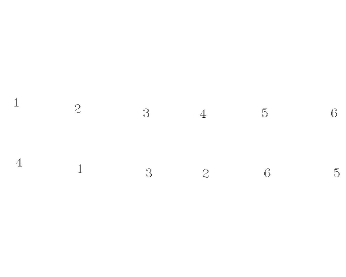

I'm struggling to find lisp that can save multiple text and allow me to change them in order of saving into other texts.
Attached some pictures to aid.
Any idea how this can be done?

Thanks steven for your response.
I have tried Lee Mac's lisp, but it hasn't what i am looking for.
The texts that need to be changed is not in one place, so i have to zoom in and out a lot.

What I am looking for is to select group of texts in my order same as "TCount" routine and be able to replace another group of text according to what i select from them in same order of first selection.
If I get asked what text to change to "1", what text to change to "2", that would be a plus.
