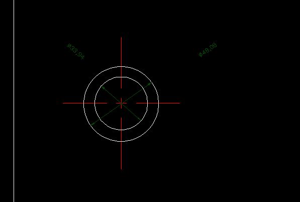

I am having a problem with the dimensions. I am trying to adjust the settings in the dimensions styles however the dimensions are not adjusting correctly. Is there something else that could be effecting the dimension style settings?
Thanks
what properties r u trying to change. did u do a dimension>update n select the required dimensions after u made the changes.
Hi,
I want the text to sit horizontal. Tried dimension update still don't work.
I want the dimension line to also be solid not dashed. I changed the settings but it's still not showing correctly.
Thanks
try typing DIMSTYLE and click MODIFY and click the TEXT tab. You should be able to get the text where you want it there. You may have to redo what's already in the drawing because I don't think it will update.
While in DIMSTYLE, click on the LINES tab and change the appearance of your lines from dashed to what you want.
