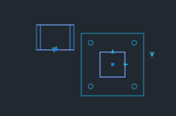

i go years where things are mostly fine and then back to this and so confused. below is image of metric drawing. both the screw and the nail .dwg files have INSUNITS, INSUNITSDEFSOURCE, INSUNITSDEFTARGET = 1
the nail comes in fine scaled and the stretch parameter works. The screw is too big and the stretch should be at the end of the screw. changing some variables the screw comes in at proper scale, but stretch is still wrong
You may want to go to original dwg and double check everything there regarding units is set matcjing destination dwg.
Also check Aecdwgsetup in both dwgs there is a setting about rescaling blocks, yes have had problems of rescale  = 1/0.3048

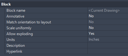

I'm back because I'm still stuck on this. "STEEL-HSS_Baseplate" works fine, the grips are where they should be. "STEEL-Steel Stud" doesn't work, the grips are in the wrong spot.
both blocks are drawn in Inches. INSUNITS on both is 1 (or can be 0 with the same result)
both have the same Properties in the second image
I've attached both files.
Stumped on this one
I just quickly recreated a block from scratch and it seems to work, but I'd really like to not recreate 1/4 of my blocks with what seems to be a glitch (3rd image)
