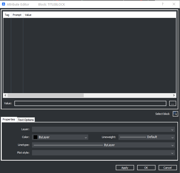

I have a LISP for adding revisions to a title block that I need help with making work in BricsCAD.
I was able to modify the LISP and have it work with one exception. I can't seem to get the Attribute editor to select the "REVISION" block. It instead, it wants to edit the "TITLE BLOCK".

Thanks for the reply BAGAL.
I inherited the job of maintaining our CAD systems and did not write the routine. I am not proficient in writing LISP routines. Not sure why the person who wrote it did in the way they did. Probably like everything else in CAD, there are a thousand different ways to do the same thing. I'm just trying to get things to work in BricsCAD.
Having said that. I will try to clarify the problem I am having.
AutoCAD opens the block editor, opens the "Edit Attribute" to be filled out, inserts the attribute into the TITLEBLOCK block, then saves and closes the block editor.
BricsCAD opens the block editor, but then the “Attribute Editor” is trying to open the TITLEBLOCK block.
Hopefully this explains it a little better.

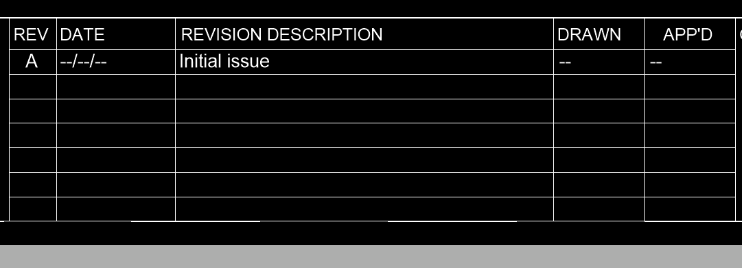

Just use BEDIT and choose title block, then can do Attedit adding revisions to original title block. Do Bclose and save, if you have existing title block do ATTSYNC, this will update the title block and make the revisions exposed. I suggest you set the default to say "-" for one of the items in the revision so you can dbl click it and the edit dcl will open. Add as many rows as you need at time of Bedit, the image above has 7 revisions with only the 1st exposed, but the others are there.
