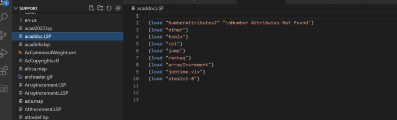

Put it in your acaddoc.lsp file. That file runs automatically when you open a drawing.

In acaddoc.lsp you would only need the line
(command "_purge" "A" "*" "N")

6 minutes ago, leonucadomi said:
 startup suite
Never used it but it seems like you added an Enter (carriage return) that's activating help. Edit startup suite and if there's a blank line use Backspace to remove it.
 Yes, that's entirely possible. Open a drawing, hit F2, and look at what commands have been run before you do anything else. That should clue you in.
