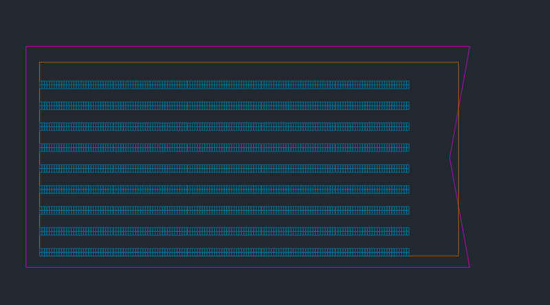

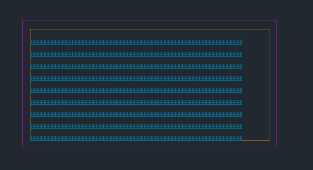

Apologies for the slow reply, thank you very much for your replies. The reason I would need to do this is because I work on designing solar farms. A time consuming part of the job is amending the fence line that goes around the solar farm. The area with panels in it is offset 2m from this fence line. I have done a bit more digging and cant find an existing command that does what i want it to do I don't believe. The paneled area is link to a plugin in AutoCad called PVcase, so every time the fence line is changed the paneled area needs changing also. But the paneled area can't be deleted and re offset otherwise there are a few processes in which I need to regenerate the panels in the paneled area.
How I think a command would work
click the first line (fence) which is going to be amended
click the second (paneled area) line that wants to be amended
then make the amendments to the first line and click enter and the second line

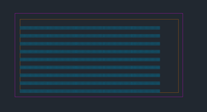

fence is pink in this image orange is the paneled area and the blue rectangles are the solar panels
Let me know if you have any smart ideas about how to go about tackling this problem.

Hi CFORD, please UPLOAD the DWG
update magenta.
Delete other polyline crossing/inside magenta
check for CW or CCW
Offset magenta in 2m
update offset polyline with new properties

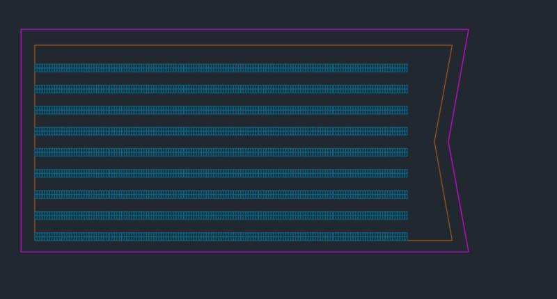

This looks like this will work, the polyline kept the same handle so it should just be two clicks. copied/edited from here
(defun c:Fence_Update (/ source target)
  (setq source (vlax-ename->vla-object (car (entsel "\nSource Polyline: ")))
        target (vlax-ename->vla-object (car (entsel "\nFence Polyline: ")))
  (vla-put-Coordinates target (vla-get-Coordinates source))
  (initget "Yes No")
  (if (= (getkword "\nDelete Source Polyline? [Yes/No]: ") "Yes")
    (vla-delete source) ; delete source polyline
--Edit 2
Above code only works with straight lines. updated the code with last post to work with bulges

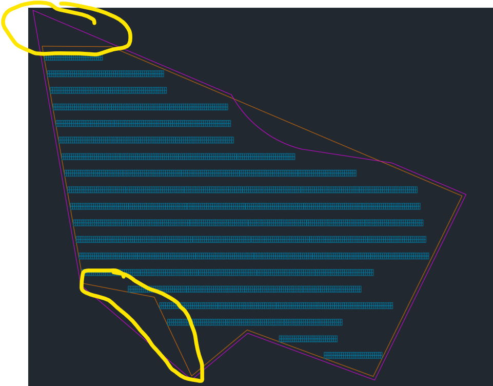

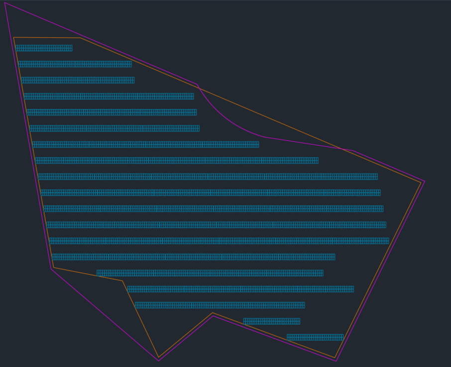

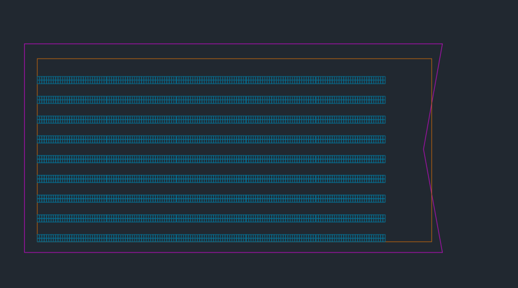

Thank you very much @mhupp that is a very good point I did not think about that. Which has made me think of something else as well the PV polyline can be a different shape to the fence line. i.e image.thumb.png.d28f773b239dc6c77f98ab04aedb0948.png
Now if I were to use the Fence_update command here it would change some areas I didn't want to change
Like so.
Is there anyway of ensuring that does not happen?

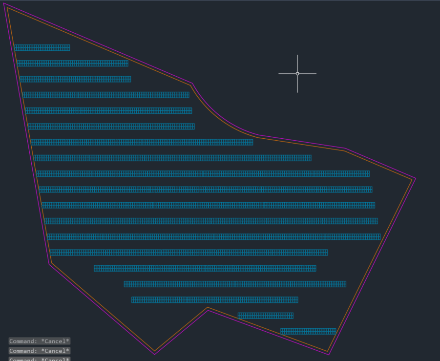

Off the top of my head.
  • during the UFP lisp make a copy of the original polyline on another layer
  • Then use the first lisp I posted to add vertexes and move grips to correct location.
  • Delete the copied polyline.

That is very clever thank you @mhupp. I guess from the check layer you can automate it even more by including a boundary command in the center of that shape that includes the check layer and then matches the PV area vertices to the boundary made and then delete the check layer after. Do you think that is something that could work?
(defun c:UFP (/ i obj1 obj2 ent off blug obj3)
  (vla-startundomark (vla-get-activedocument (vlax-get-acad-object)))
  (setq i 0)  ;; parameter index
  (setq obj1 (vlax-ename->vla-object (car (entsel "\nSource Polyline: ")))
        obj2 (vlax-ename->vla-object (car (entsel "\nPolyline to Update Polyline: ")))
  (entmake '((0 . "LAYER") (100 . "AcDbSymbolTableRecord") (100 . "AcDbLayerTableRecord") (2 . "CHECK") (70 . 0) (62 . 1) (290 . 0))) ;make new layer that is red and plotting is turned off
  (setq poly (vlax-invoke obj2 'copy))
  (vla-put-layer poly "CHECK")
  (setq off (vlax-invoke obj1 'offset (if (CW obj1) 2.0 -2.0)))  ;offset to inside
  (if (<= (length off) 1)
    (setq bulg (mapcar 'cdr (vl-remove-if-not '(lambda (x) (= (car x) 42)) (entget (vlax-vla-object->ename (setq off (car off)))))))
      (alert "\nMore Than one Offset Detected")
      (quit)
  (vla-put-Coordinates obj2 (vla-get-Coordinates off))
  (foreach b bulg
    (vla-setbulge obj2 i (nth i bulg))
    (setq i (1+ i))
  (vla-delete off)
(setq obj3 (getpoint "\nPick internal point: "))
   (command "_.-boundary" "_a" "_i" "_n" "" "" "_non" obj3 "")
(vla-put-Coordinates obj2 (vla-get-Coordinates obj3))
(foreach b bulg
    (setq i (1+ i))
  (vla-endundomark Drawing)
  (vla-delete obj3)
So this is how far I got I dont know if you can tell what I was trying to do here but I tried making the boundary command and set it to obj3 and then set obj2 coordinates to obj3. Unfortunately it didn't work it seemed to get stuck after making the boundary command? let me know if you can tell me why it didnt work?
Thank you for all the help so far :)
I have had another go at this today to try and figure this out? it works mostly except at the end I can't seem to get the bulges to match the boundary that I made.
The code also should delete the "check" layer at the end and obj3 but that did not seem to work either.
If you know a smart way of not having to select the obj3 that was created and instead and re-select the obj2 again to update obj2's coordinates to obj3 that would be really useful as well?
