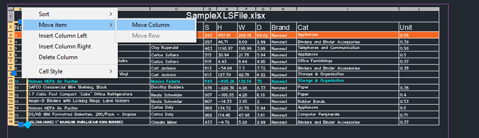

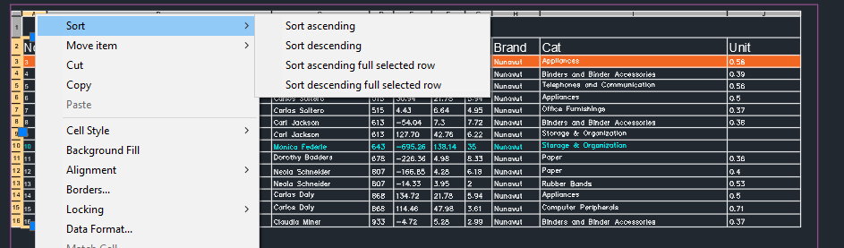

Danielm103 Posted November 24, 2022 Posted November 24, 2022 (edited) Probably still has a ton of bugs, just looking for feedback to see if this works with your tables the installer is a .bundle and an arx, nothing is written to the registry... Sort menu; Sort expects to the column to be the same datatype. The module tries to convert text numbers to real numbers before sorting Sort ignores: -first row if it’s a title row. -second row if it’s a header row. Sort menu is greyed out when: -there’s merged cells (except title) -locked or read only content or format -cell overrides this module doesn’t understand (modified gridlines) -has a datalink -cell has a block or multiple content Move menu is greyed out when: -Inside a cell -range spans multiple rows/or columns -cell overrides this module doesn’t understand (modified gridlines) -has a datalink -cell has a block or multiple content -has a merge that’s outside the range Command: CEXTABLESORTERROR Prints the last 10 reasons why the menu was greyed Command: CEXTABLESORTVER Prints the version number TableSort 1.1.90.msi Edited November 24, 2022 by Danielm103 Quote
Danielm103 Posted November 24, 2022 Author Posted November 24, 2022 (edited) here's a couple screenshots Edited November 24, 2022 by Danielm103 Quote
