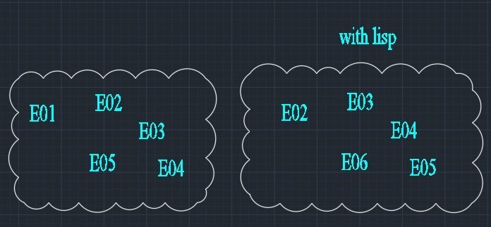

Hi again , i need a lisp that converts all selected texts to added 1 texts , for example there 5 texts written 1,2,3,4,5 when i use the lisp i select all in the window i use the lisp and they all become 2,3,4,5,6. or maybe texts are for example  T 1,T2,T3,T4,T5 and when i use the lisp they become T2,T3,T4,T5,T6 .  i need this not selecting one by one but at once.

Try this, command is txt+.
Notes: Will increase A to Z, with Z returning to A (A, - > B -> C.... Z -> A and not say, AA), numbers will follow usual rules and dates in the format dd/mm/yy else will just increase the year
Copied from other stuff - if I have missed copying anything let me know

Increment the last character, if the last character is the end limit, also increment the previous character, this for the whole string
Example AZ -> BA or 199 -> 200
Works with TEXT MTEXT MULTILEADER and DIMENSION
