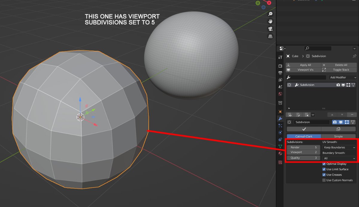

Cad64 Posted December 1, 2022 Share Posted December 1, 2022 Yeah, you have to use the subdivision modifier in order to get the smooth rounded edges. Too bad your laptop isn't up to the task. That's a bummer. Did you try dropping the Viewport subdivision levels down? You can keep the Render subdivisions high, so it will render smoothly, but keep the Viewport subdivisions low so it doesn't bog down your computer while you're working. It won't look smooth in the Viewport but it will render smooth. In the image below, I put a subdivision modifier on a cube. The object in the foreground has viewport subdivision set at 2. The object behind it has viewport subdivision set to 5. Quote Link to comment Share on other sites More sharing options...

Cad64 Posted December 2, 2022 Share Posted December 2, 2022 If you have an older computer, you might want to try installing an older version of Blender. Try version 2.9 and see if you have better luck: https://www.blender.org/download/releases/2-90/ Quote Link to comment Share on other sites More sharing options...

Cad64 Posted December 2, 2022 Share Posted December 2, 2022 Actually, I just checked the link I provided and you can't download older versions from there. If you want to download an older version, follow the link below, then click on the version you want to download, like Blender 2.90. This will take you to another page where you can download the blender-2.90.1-windows64.zip file. https://download.blender.org/release/ Quote Link to comment Share on other sites More sharing options...
