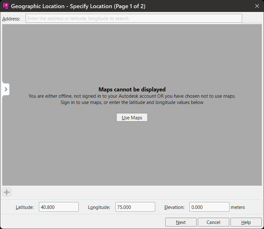

Saqib_theleo Posted December 8, 2022 Posted December 8, 2022 Hello all, Can someone guide me In Civil3d online Maps are free or need subscription. I am unable to use online maps. I have an Autodesk account. Thank you. Quote

SLW210 Posted December 9, 2022 Posted December 9, 2022 IIRC, you shouldn't use the GEOLOCATION in Civil3D, set the coordinates with _MAPCSASSIGN. See this article as well, it applies to AutoCAD, but might help you. AutoCAD: Maps Cannot Be Displayed | AutoCAD | Autodesk Knowledge Network Quote
Saqib_theleo Posted December 9, 2022 Author Posted December 9, 2022 6 hours ago, SLW210 said: IIRC, you shouldn't use the GEOLOCATION in Civil3D, set the coordinates with _MAPCSASSIGN. See this article as well, it applies to AutoCAD, but might help you. AutoCAD: Maps Cannot Be Displayed | AutoCAD | Autodesk Knowledge Network I have assigned related coordinates to drawing but when I want to show maps they don't appear. Quote
BIGAL Posted December 9, 2022 Posted December 9, 2022 A map as you imply can be just an image with its co-ordinates based at 0,0 so the image may be there but waaaay over there, using JPG and a JGW and a lisp moves the image to correct world co-ordinates. If you google a couple of Utubes about inserting geo related images it should make sense, sorry don't have any links. Quote
Subidoooo Posted December 30, 2022 Posted December 30, 2022 you have to log in with your email adress, once logged in you will have access to the geolocation tab Quote
