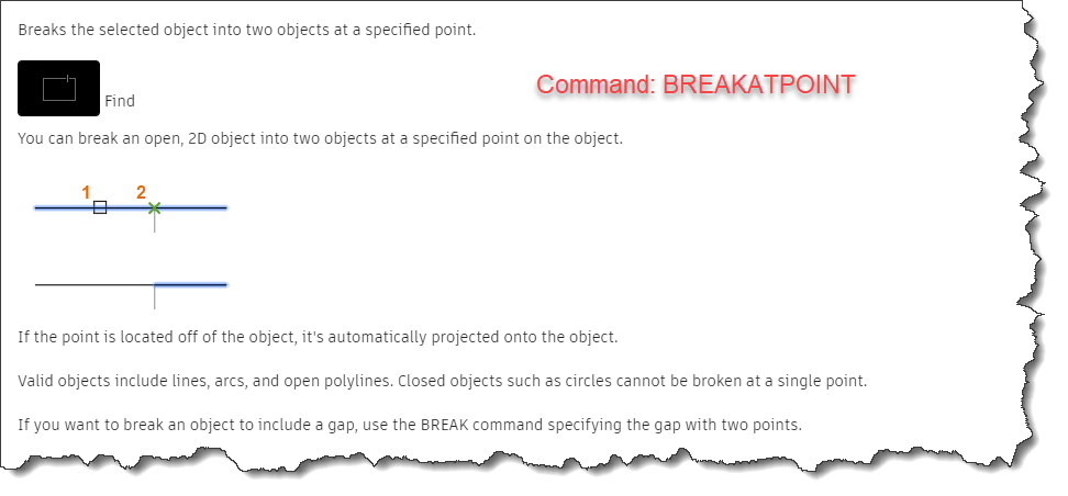

troggarf Posted January 2, 2023 Share Posted January 2, 2023 (edited) There is a new BREAKATPOINT command that does this. I made an alias of BAP for it Edited January 2, 2023 by troggarf Spelling 2 Quote Link to comment Share on other sites More sharing options...
