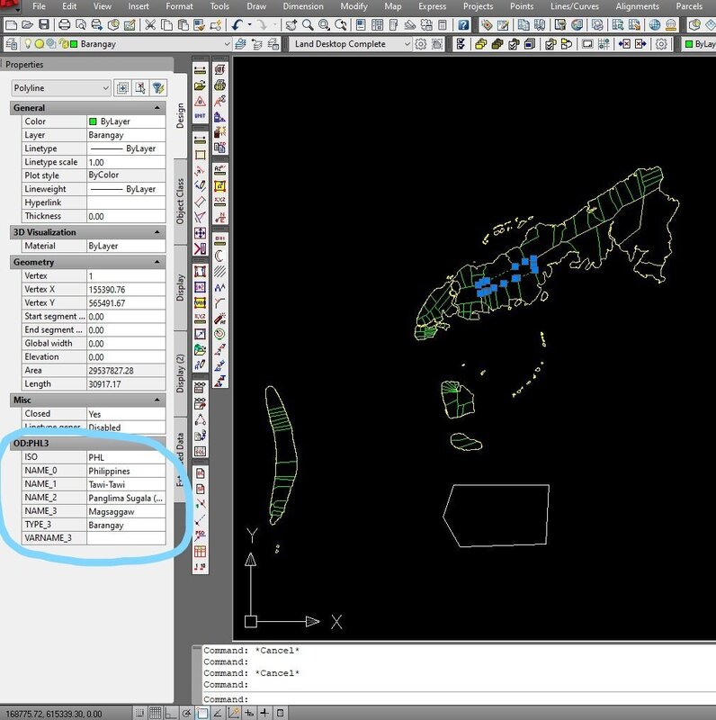

What autocad function is the section in the properties bar which i marked blue in the attached drawing so i can search for tutorials of doing one.  It does not function in lower version of autocad. Btw i use Autocad 2019 Landdesktop. Thank you

That is OBject Data, you need to have say CIV3D or Map to get at that info.
(setq ent (car (entsel "\nPick object with OD data ")))
(setq odname (ade_odgettables ent))
(setq Stnum (ade_odgetfield ent odname "STREET_NUMBER" 0))
(setq Stname (ade_odgetfield ent odname "STREET_NAME" 0))
Try "Name_0" for the data name in example code.
  • Like 2
Thank you for your answer and the code BIGAL. Can i run that code after saving as lisp and load using appload? I will try if i can get through LD2009.
Not sure if supported in LD2009 just try copy 1 line at a time and paste to command line.
(setq Stnum (ade_odgetfield ent odname "NAME_0" 0))
