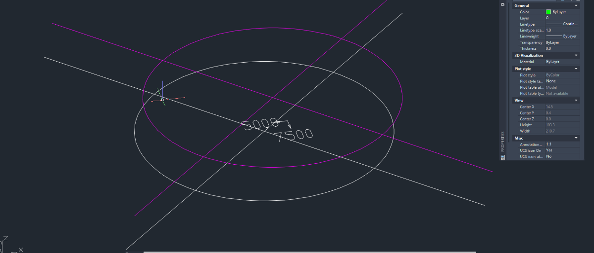

Firstly I work in mm and the text output in this lisp doesn't show a decimal point , 5mm is shown as 5000. Can anyone advise what i need to chasnge me how to make it display as 5.0 ?
Units is set to mm but stuff was drawn in M need to scale everything down 1:1000

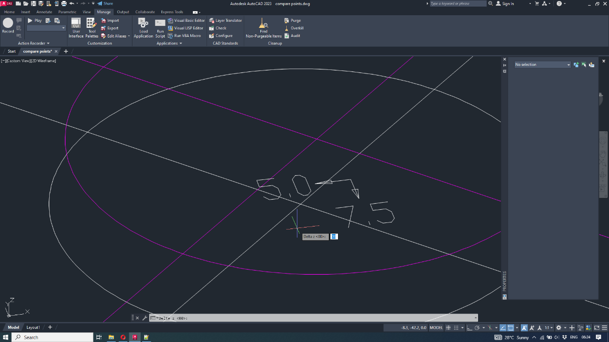

Please see attached drawing and screen shot. White point is 0,0,0 & purple point 5.0,7.5,10. And it is show as 5000 & 7500 as screen shot. I have check my units in drawing, and it does the same whichever units & presision are set.

As I can see here is the issue
(command "-INSERT" blnam "_S" cmp:scal inpt "0" (rtos (abs (* (car  deval) 1000)) 2 0) (rtos (abs (* (cadr  deval) 1000)) 2 0))
It multiply by 1000
It shall be
(command "-INSERT" blnam "_S" cmp:scal inpt "0" (rtos (abs (* (car  deval) 1.000)) 2 0) (rtos (abs (* (cadr  deval) 1.000)) 2 0))
Multiply by 1

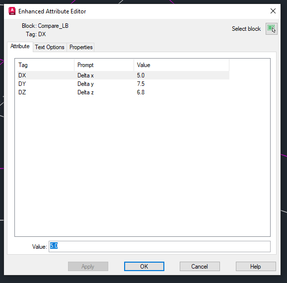

I change the multipliers from 1000 to 1.000 and also changed the precision from 0 to 1 and that is bit is working good now, Thank you.
I have added lines to the in the set block function for the delta z.  This works in the block, but prompts me to type in the z value. I cant see the link from the block attribute to where it getting its information from - theres no Dx or Delta x in the rest of the script

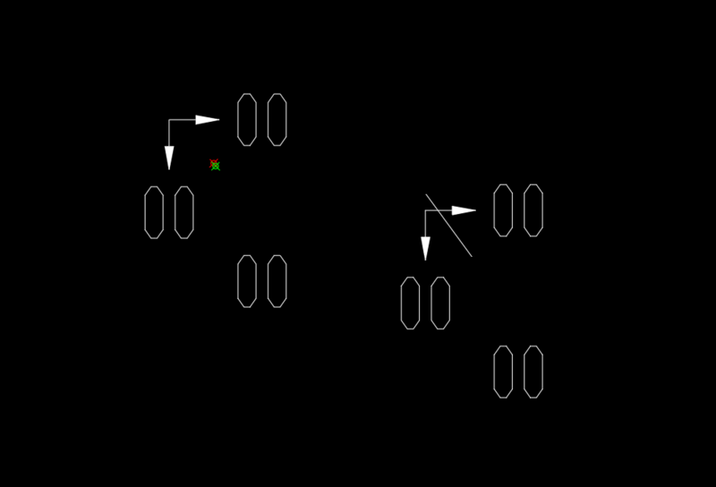

;; This section Entmake's the "ROMAN" style and the 4 required blocks on loading the routine.
looks good. but if something isn't working right create the block or point how you want and then use this lisp from CAB.
http://www.theswamp.org/index.php?topic=31145
When inserting a block with attributes it asks for their inputs by defualt. So you should just need to update the insert command to add the Dz.

**  (command "-INSERT" blnam "_S" cmp:scal inpt "0" (rtos (abs (* (car  deval) 1.0)) 2 0) (rtos (abs (* (cadr  deval) 1.0)) 2 0) (rtos (abs (* (caddr  deval) 1.0)) 2 0))
-edit
just need 1.0
Edited by mhupp
Thanks mhupp. That makes a lot more sense now. Cheers

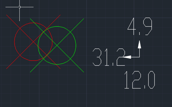

As you suggested just adding the Dz to the insert command has worked, and the lisp is working pretty much as i need now, except the "dz" does not show a minus symbol when its required. Ive has a search but couldn't find anything. Do you have any ideas why it wouldnt be showing ?
Also is it possible to add pretext to the caddr valve, I just wanted to put a "H" before it.
Thanks again for your help.

Do you mean you get an error when you run the lisp ? Or there is a error in the programming ?
Was missing a few ")"
the Arrows in the block points to the direction of the x and y offset. They are always going to be positive values. changed it so the Z is either positive or negative. sorry for the delay.
compare.lsp
Edited by mhupp
Thank you Mhupp, works perfect now. Cheers
