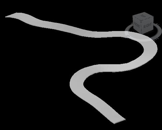

rustysilo Posted February 19, 2009 Share Posted February 19, 2009 I'm trying to model a roadway in 3d with regular AutoCAD as opposed to Civil 3d (just for fun mostly). My idea was to draw a cross section of the roadway and then sweep it along the centerline which is a 3d polyline, but the section is twisting as it sweeps down the 3d poly. Is there any way to keep it from twisting or is that just the natural behavior? Maybe a better option might be to copy this cross section at intervals along the 3d poly and then loft them together using the centerline as a path? Quote Link to comment Share on other sites More sharing options...

MaxwellEdison Posted February 19, 2009 Share Posted February 19, 2009 Here's my loft before and after. 3D ROAD - BEFORE AND AFTER.dwg Quote Link to comment Share on other sites More sharing options...

rustysilo Posted February 19, 2009 Author Share Posted February 19, 2009 Here's a grab of the one I did using sweep. Notice how the first one is horizontal, but the last one is tilted. I'm doing one that has a crown (3% slopes) with curb & gutter in this case. Quote Link to comment Share on other sites More sharing options...
MaxwellEdison Posted February 19, 2009 Share Posted February 19, 2009 Loft does not twist the road surface. The image I attached below took longer to add height to the vertices of the spline than anything else, Quote Link to comment Share on other sites More sharing options...
rustysilo Posted February 19, 2009 Author Share Posted February 19, 2009 But do a front or side view of it, then use 3dorbit to rotate about that axis. Look closely at the road and you will notice it tilts ever so slightly around the curves, or at least it sure looks like it to me. Create some sections with sectionplane at various points perpendicular to the roadway and when you generate the 2d sections you will see. It looks to me like when the 3dpoly has vertical changes around the curves it twists slightly. Look at my screen grab. I'm tellin you man IT'S TWISTED!!! Please tell me I'm not going crazy. Quote Link to comment Share on other sites More sharing options...
