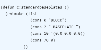

Redefined block by code problem
I've made a program to redefine a block between 2 forms. They are fairly basic blocks with a polyline and circles. The problem is the block still behaves like the original in regards to selection. Clicking the new block doesn't work. It's like there's a ghost of the original block that you have to use to interact with it. Is there some regen or similar function that would fix this?
Here's the code for reference.
(defun c:standardbaseplates ()
  (entmake (list
             (cons 0 "BLOCK")
             (cons 2 "_BASEPLATE_")
             (cons 10 '(0.0 0.0 0.0))
             (cons 70 0)
  (entmake (list
             (cons 0 "LWPOLYLINE")
             (cons 100 "AcDbEntity")
             (cons 100 "AcDbPolyline")
             (cons 90 8)
             (cons 70 0)
             (cons 62 256)
             (cons 8 "0")
             (cons 10 (list -0.875 -4.75))
             (cons 10 (list -3.5 -4.75))
             (cons 10 (list -3.5 -1.0))
             (cons 10 (list -2.25 0.25))
             (cons 10 (list 2.25 0.25))
             (cons 10 (list 3.5 -1.0))
             (cons 10 (list 3.5 -4.75))
             (cons 10 (list 0.875 -4.75))
  (entmake (list
             (cons 0 "CIRCLE")
             (cons 10 (list 2.5 -3.75))
             (cons 40 0.3125)
             (cons 62 256)
             (cons 8 "0")
  (entmake (list
             (cons 0 "CIRCLE")
             (cons 10 (list -2.5 -3.75))
             (cons 40 0.3125)
             (cons 62 256)
             (cons 8 "0")
  (entmake (list
             (cons 0 "ENDBLK")
             (cons 8 "0")
  (vla-regen (vla-get-activedocument(vlax-get-acad-object)) acAllViewports)

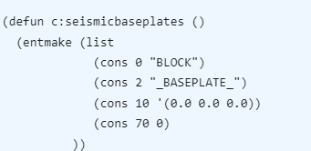

(defun c:seismicbaseplates ()
  (entmake (list
             (cons 0 "BLOCK")
             (cons 70 0)
  (entmake (list
             (cons 90 6)
             (cons 70 0)
             (cons 62 256)
             (cons 8 "0")
             (cons 10 (list -0.875 -6.0))
             (cons 10 (list -4.0 -6.0))
             (cons 10 (list -4.0 2.0))
             (cons 10 (list 4.0 2.0))
             (cons 10 (list 4.0 -6.0))
             (cons 10 (list 0.875 -6.0))
  (entmake (list
             (cons 0 "CIRCLE")
             (cons 10 (list -3.0 -5.0))
             (cons 40 0.3125)
             (cons 62 256)
             (cons 8 "0")
  (entmake (list
             (cons 0 "CIRCLE")
             (cons 10 (list -3.0 1.0))
             (cons 40 0.3125)
             (cons 62 256)
             (cons 8 "0")
  (entmake (list
             (cons 0 "CIRCLE")
             (cons 10 (list 3.0 -5.0))
             (cons 40 0.3125)
             (cons 62 256)
             (cons 8 "0")
  (entmake (list
             (cons 0 "CIRCLE")
             (cons 10 (list 3.0 1.0))
             (cons 40 0.3125)
             (cons 62 256)
             (cons 8 "0")
  (entmake (list
            (cons 0 "ENDBLK")
            (cons 8 "0")
The intention is to redefine BASEPLATE. Not create 2 different blocks of the same name
The problem is, after it's redefined you can't click on the new geometry. It only selects it from where the old geometry used to be. As if it's not fully redefined.
For me look at a dynamic block you can enter parameters and the object will change size to suit. Len & Ht, Rad, offset X & Y
Or a lisp that draws the plate to the size you want then can make a block of the new baseplate "Base300x200" the name from the values entered.
Something like make a selection set of what was just created then use  "-block" follow the prompts to see how you would do in a (command "-block"
