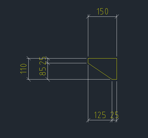

How to modify this lisp to correct dim distance when there are more than 1 dimension from the object.
These two pictures below is a before and after for an object that has only 1 dimension. It successfully change the distance from 100 to 200.
1.PNG.5f2feb26fd25e30efe706350f8db80f8.PNG  2.PNG.145997ed7e8c3e8a0b7b8ed685090db2.PNG
But on this different plate with 1st and 2nd dimension. Somehow the outcome is what is not desired/expected, which is to keep the distance of the 1st dimension from the 2nd and only affect the 2nd dimension as the max value from the dim distance input.
Code by exceed from this thread:
It is a picture , not a dwg .
AFIK , ACAD can not edit pictures.
Please upload your sample.DWG
This is being asked for over at forums/autodesk, its about resetting the dim offset from the object, say current dim offst is 10 but want 12.5. There was an answer plays with the dxf 13 & 14 codes.
