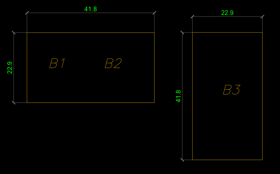

hi everyone.
i have someone made this lisp and i want it modified
what it does:
it extracts the length and width of rectangles (length as horizontal dimension width as vertical dimension) and the ref ID inside the rectangle and puts it into excel
what i wanted:
sometimes there are multiple ID ref inside the rectangle, i want to include all ID's on the cell

You get a selection set of text, 1 or more so convert the text into a string you would use something like this then write to file
(setq tstr "")
(repeat (setq x (sslength ref))
  (setq str (cdr (assoc 1 (entget (ssname ref (setq x (1- x)))))))
  (setq tstr (strcat tstr "," str))
Just a comment you can write direct to Excel no need to use a csv.
