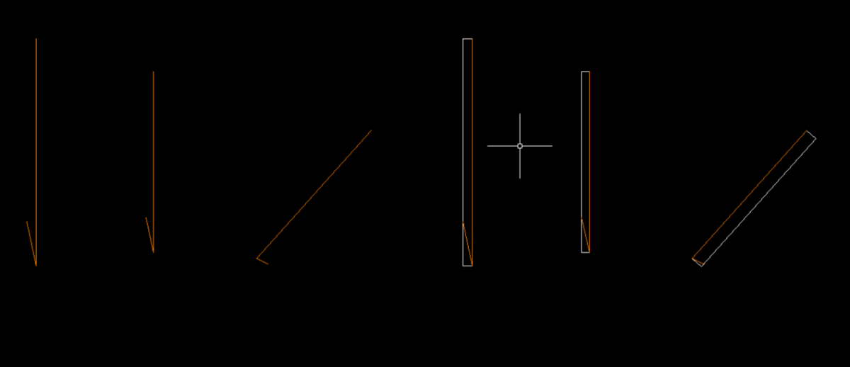

Jamesclark64 Posted March 28, 2023 Posted March 28, 2023 Don't know if this is actually possible or not but I'm trying to come up with a way to automatically turn a two line pollylines into a rectangles. Using the long line as a baseline and the short line as an offset. Anyone know of anything like this or how I'd even start on attempting it. Quote
BIGAL Posted March 28, 2023 Posted March 28, 2023 Just pick pline, if they are always 2 segments then get length of each segment the shorter defines the endpoint which is used in vlax-curve-getclosestpointto so can work out offset distance, then just do some polar calcs and draw a new rectang. or Pick an end on longer side this defines which end is to be called start and the other end. So again use getclosestpointto using correct point, when you use entsel you get a point so can compare distance pt-start pt-end and swap the start and end points for the calcs. Quote

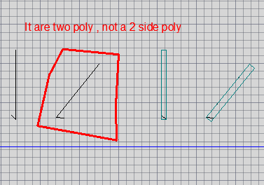

Jamesclark64 Posted March 29, 2023 Author Posted March 29, 2023 1 hour ago, devitg said: @Jamesclark64, please upload a sample dwg. Sure. Here's two examples one vertical and one diagonal. example.dwg Quote
devitg Posted March 29, 2023 Posted March 29, 2023 18 minutes ago, Jamesclark64 said: Here's two examples one vertical and one diagonal. @Jamesclark64, but you ask for 2 side polys, no for 2 polys side Quote
Jamesclark64 Posted March 29, 2023 Author Posted March 29, 2023 17 minutes ago, devitg said: @Jamesclark64, but you ask for 2 side polys, no for 2 polys side Sorry I don't think I worded my original post well. Its essentially a polly made from two separate lines. The longer of the two lines is the baseline and the end of the short line is the extent of the offset. Quote
devitg Posted March 29, 2023 Posted March 29, 2023 52 minutes ago, Jamesclark64 said: polly made from two separate lines @James , so There are 2 polys , in contact at a common point, but not a polys with 3 vertex. Please upload a sample.dwg with such condition Quote

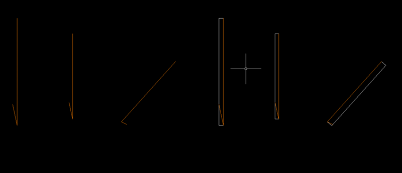

Jamesclark64 Posted March 29, 2023 Author Posted March 29, 2023 1 hour ago, devitg said: @James , so There are 2 polys , in contact at a common point, but not a polys with 3 vertex. Please upload a sample.dwg with such condition I'm such an idiot. Must have exploded it before uploading. Please try this one. example2.dwg Quote
devitg Posted March 30, 2023 Posted March 30, 2023 @Jamesclark64 Find attached DWG , and LISP draw rectangle from 3 vertex lwpolylines-01.LSP rectangles drawn from 3 vertex polys.dwg Quote

Jamesclark64 Posted March 30, 2023 Author Posted March 30, 2023 15 hours ago, devitg said: @Jamesclark64 Find attached DWG , and LISP draw rectangle from 3 vertex lwpolylines-01.LSP 3.85 kB · 6 downloads rectangles drawn from 3 vertex polys.dwg 48.8 kB · 3 downloads This is fantastic! I can't thank you enough! Is there a way I can send you some dollars for a few beers? Quote
