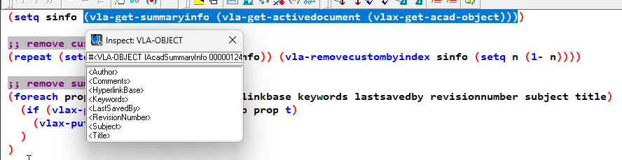

Delete ALL Custom Properties - Help!
My desire was to simply delete all custom properties regardless of name or order or information.
I found this code here
(setq sinfo (vla-get-SummaryInfo (vla-get-ActiveDocument (vlax-get-acad-object))))
;; remove custom infos
(repeat (setq n (vla-NumCustomInfo sinfo))
(vla-RemoveCustomByIndex sinfo (setq n (1- n)))
(foreach prop '(Author Comments Hyperlinkbase
Keywords LastSavedBy RevisionNumber
Subject Title
(if (vlax-property-available-p sinfo prop T)
(vlax-put-property sinfo prop "")
It does eventually delete all the custom properties but it opens the drawing properties dialog first then opens the purge dialog 3 times (in the current dwg).
Can some please help me clean this up such that it only deletes all the custom properties without all the annoying extras?
My desire is a (defun c:xxx that I can run clean.
Does the
(foreach prop
above relate to specific property names?
I do not have those specific properties per se
No where in that code is PURGE used? I just tried it here and it works without any popups.
You should have the (foreach prop ..
I have no idea.
Purge was not in my history either...
In the meantime I came up with this... (works for me)

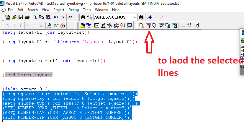

I have found <personally> that sometimes when I paste code in at the command line that I get weirdness..
I should have put into in a file and then try loading it..
any way I'm good.
Edited by ILoveMadoka
@ILoveMadoka if you use VLIDE from ACAD, you can LOAD to test as many program lines
