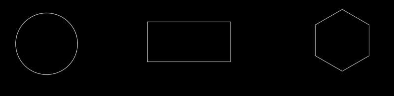

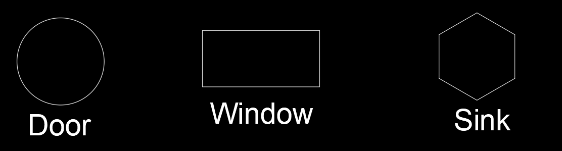

How can I modify this to have it only apply to SPECIFIC blocks?
ie: block names =  Door, Window, Sink
I saw some posts with something like this but I could not make it work
(setq xxx (ssget "X" (list '(0 . "INSERT") (2 . "Door,Window,Sink") (cons 410 (getvar "ctab")))))
Please advise..

These are not dynamic blocks.
(they are just examples that I made...)
