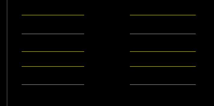

hello people:
can someone help me to improve this or if there is another way.
please.
the purpose is to create a rectangle and delete everything that is inside and then delete the rectangle.
I would like to just create the rectangle and delete what is inside and at the end the rectangle disappears
(defun c:test ( /  )
(command "_rectangle" "\\" "\\")
(setq ent1 (entsel))
(setq pt1 (getpoint))
(if
(cond
(etrim)
(T (load "extrim.lsp" "") etrim)
(etrim (car ent1) pt1)
(setvar "HIGHLIGHT" 1)
(command "_erase" ent1 "")
any help is good
@leonucadomi Instead to make the rectangle , you can do a  Window or Cross selection , and erase windowed or crossed entities.
Window from down left to up right
or cross from upright to left  down
Edited by devitg
add comment
what I want is to break the lines and delete what remains inside that rectangle
This can be done by EXTRIM command in the Expresstools if I understand your concern correctly.
So a break lines with a gap size ? Pick a point say top line use perp pick bottom line then gap, all done. Is that what you want ? Gap is based on pick point so say MID could be used for a left and right of middle of a line.
