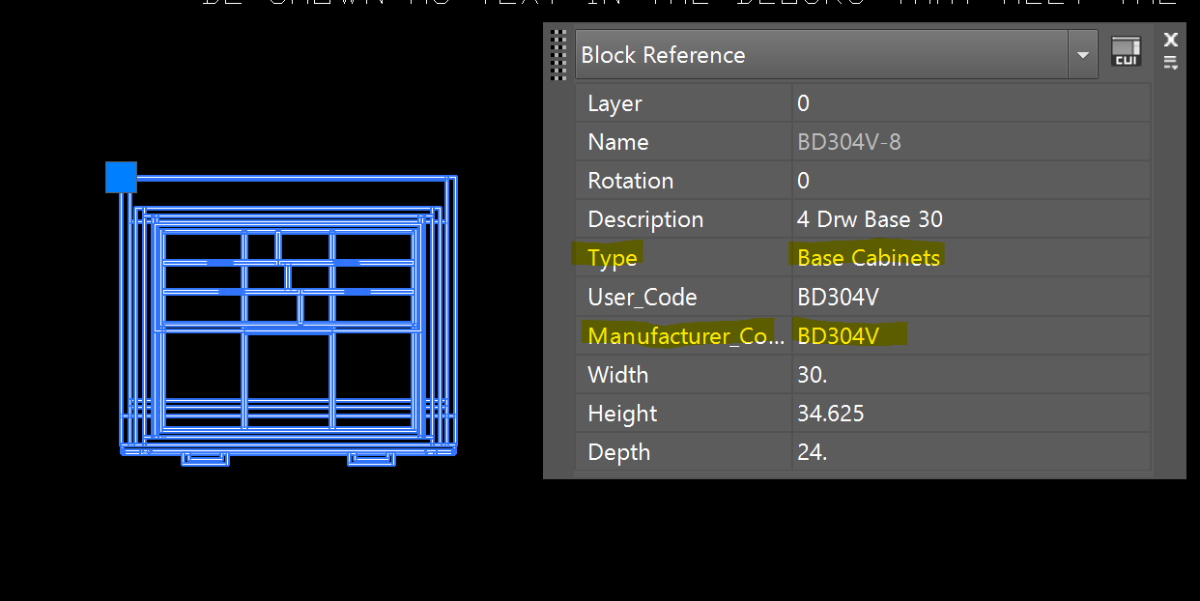

Is it possible to retrieve only one specific value of a block as a text depending of another value? (if, then)
stlo
Hi everyone! I'm wondering if it's possible to retrieve one value of a block depending on what another value of that same block is and show that value as a text over that same block? I would be kind of an isolated value of the BURST command I guess but keeping the Block as a Block. I'm joining a dwg with details in it and a screen capture! I hope it's enough clear! :) Thank you very much!

Build a selection set of blocks with attributes.
for each block
step thought each attribute and save the "type" and "manufacturer_code"
if type is a matches a predefined list '("Base Cabinets" "Wall Cabinets" "Tall Cabinets")
then get a bounding box of the current block.
calculate the mid point
and create text with the "manufacturer_code" at the mid point.
;; Pull Manufacturer_Code for cabinets and input them center of block
(defun C:CAB-Label (/ Drawing ss blk atts att typ man minpt maxpt MPT)
  (vl-load-com)
  (setq i 0)
  (vla-startundomark (setq Drawing (vla-get-activedocument (vlax-get-acad-object))))
  (prompt "\nSelect Blocks: ")
  (while (setq ss (ssget '((0 . "INSERT") (66 . 1)))) ;allows user to make multiple selections
    (setvar 'cmdecho 0)
    (foreach blk (mapcar 'vlax-Ename->Vla-Object (vl-remove-if 'listp (mapcar 'cadr (ssnamex ss))))
      (setq atts (vlax-invoke blk 'getattributes))
      (setq typ "" man "")
      (foreach att atts
        (cond
          ((= (vla-get-tagstring att) "Type")
              (setq typ (vla-get-textstring att))
          ((= (vla-get-tagstring att) "Manufacturer_Code")
              (setq man (vla-get-textstring att))
      (if (member typ '( "Base Cabinets" "Wall Cabinets" "Tall Cabinets")) ;update list for other blocks
          (vla-GetBoundingBox blk 'minpt 'maxpt)
          (setq MPT (mapcar '/ (mapcar '+ (vlax-safearray->list minpt) (vlax-safearray->list maxpt)) '(2 2 2)))
          (entmake (list '(0 . "TEXT") (cons 10 MPT) (cons 11 MPT) (cons 40 (getvar 'textsize)) (cons 1 man) '(62 . 1) '(72 . 1) '(73 . 2)))
          (setq i (1+ i))
  (prompt (strcat "\n" (itoa i) " Cabinets labeled")) ;message at the end
  (vla-endundomark Drawing)
  (setvar 'cmdecho 1)

Hi mhupp!! Wow! This is awesome! Thank you very much! This is exactly what I was thinking about!
It's very helpful!
Have a great day!
