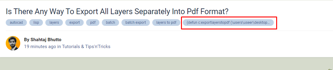

Shahtaj Bhutto Posted June 6, 2023 Share Posted June 6, 2023 (edited) Hi Is there any way to export all layers separately into pdf format? i want to export all of them at once to edit them in illustrator. It's taking alot of time to export them one by one from autocad I don't have any professional Experience with programming but i have tried to made this .lisp with chatGPT but it's not working to export files which property in codes needs improvements please (defun c:ExportLayersToPDF (\Users\Useer\Desktop\pdf layers) (setq dwgname "EMERALD HILLS MP (2007) 25 01 2023") ; (setq dwgpath "F:\Shahtaj Ahmed Bhutto\AUTOCAD") ; (setq layname "") (while (setq layname (tblnext "LAYER" layname)) (and layname (/= layname "0") (/= layname "DEFPOINTS") (/= (logand (cdr (assoc 70 (tblsearch "LAYER" layname))) 1) 1) (progn (setq pdfname (strcat dwgname "_" layname ".PDF")) (setq pdffullpath (strcat dwgpath pdfname)) (command "-plot" "Yes" "Model" "" "" "DWG To PDF.pc3" "A0" "PORTRAIT" "Inches" "Fit" "Center" "No" "No" "No" "Yes" "No" "No" "Yes" "Yes" pdffullpath) T ) ) ) (princ) ) Edited June 6, 2023 by SLW210 Added Code Tags Quote Link to comment Share on other sites More sharing options...

SLW210 Posted June 7, 2023 Share Posted June 7, 2023 Might help to explain what's wrong with your code. 1 Quote Link to comment Share on other sites More sharing options...
Shahtaj Bhutto Posted June 7, 2023 Author Share Posted June 7, 2023 1 minute ago, SLW210 said: Might help to explain what's wrong with your code. let me reshare the code i have tried to edit but it's not working i just want to export layers separately to pdf file. but i did not be able to find .lisp for "layer to PDF" some how i got .lisp for "layer to DWG" here is the code i'm trying to make Layer to pdf .lisp ExportLayersTOPDF (1).lsp but when i run this in autocad it's giving error I mean it's not working Quote Link to comment Share on other sites More sharing options...
SLW210 Posted June 7, 2023 Share Posted June 7, 2023 What exactly is the error? You could run the "Layers to DWG" LISP and then batch plot them to PDFs. Quote Link to comment Share on other sites More sharing options...
BIGAL Posted June 7, 2023 Share Posted June 7, 2023 Quick look it does not seem to have turn layers on off ? (setvar 'clayer layname) (command "-layer" "off" "*" "N" "") plot............ (command "-layer" "on" "*" "") Quote Link to comment Share on other sites More sharing options...
