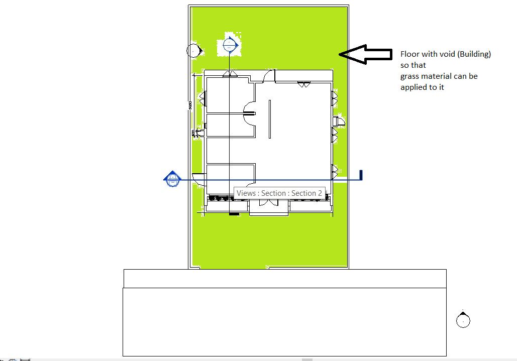

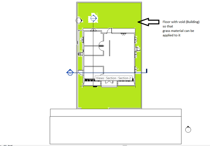

I need to create a floor with a void (area taken by building) and another area for driveway and parking to which I will add Grass material.  In Autocad I will do substraction or can be done using region, but what is the procedure using Revit.  image.thumb.png.8f029c4725f64f0b64fac70d5433b035.png
Click that Green Floor and Edit it's boundary (Under Modify Tab). Create the Building Boundary inside.
