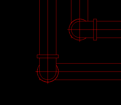

I need one help. let me explain that
need to insert one block between 3 lines (pipe) Intersection point and automatically rotate the block suitable for routing after inserting trim remaining area (same as lee mac auto block break) if can measure the distance 3 line and scale the block
1. I will create a block suitable for 100 mm pipe
2. for pipe will use multiline. and after I will explode. because multiline will not vary the pipe size, pipe size will be okay.
3. I need to insert that block on the Intersection point with scale so I can use different pipe sizes with the same block.
4. I will use only this tool 0° 90° 180° 270° pipe angle (so I can use the same block) check the 2 angle of pipe routing and rotate the block as that need(i will make all block the same angle  )
5. after the Intersection, trim the remaining area.
* if I can set the block on the first time from the drawings that will be good
* same as window selection that will be great
please check the drawing that will help full for what am thinking

This is what I need but here are some suggestions. the block is not rotating properly. the same angle if I draw reverse the block is not rotating properly. and if I can draw continuously that will be good. same like pipe draw in Revit.
Edited by Ajmal
I was a bit worried about direction will have  a think about it and add the correct trim.
Not sure what you mean the direction is based on the way the center line pline is drawn, this is left -> right, then right -> left. Can you clarify please. Could add a question "FLIP" ?
Edited by BIGAL
Try this I added things to @BIGAL code, no trimming but scaling instead. And angles should work fine. Tested it and it seems working, but only problem is it breaks on error after first time you run the function in drawing. Don't know why, I made all variables local I think. Maybe someone can debug and figure out why is that?

This is what i expect 🥰🥰🥰🥰, thanks. great tool.
I have one more suggestion. let me explain. this
1. for pipe size type "d" I need to change it so I can put whatever pipe size
2. for visibility only multi-Radio buttons.
3. (optional) If I can change the visibility while drawing pipe by typing "s" that will be great (if too much am asking no need for this 😉)
In the radio buttons bit can add "Other" then it will ask for size. Also a bit hidden if you run again can set the buttons to last selected so just hit OK. Will show how.
(setq lst1 (list "Select Dia " "25" "32" "50" "82" "110" "Other"))
(if (= (nth ah:2col lst1) "Other")
(setq dia (getreal "\nEnter dia size ")
(setq dia (/ (atof (nth ah:2col lst1)) 2.0))
(setq ah:but ah:2col ah:but2 ah:2col2)
  • 3 weeks later...
