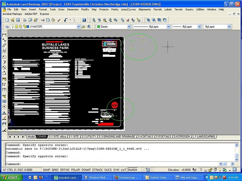

In that case it is most likely your graphics card or your settings under Options>System.
Ordinarily that would be caused by PDMODE, but in the original posters problem, it could not be fixed on his computer, but went away on a co-workers computer. If this is your co-worker's case as well, then the problem is with the co-worker's computer. As I mentioned earlier seems like a graphics card issue, but in retrospect, I also would mention that you need to make sure you have all Service Packs and Updates installed as well as the latest Hardware Certification Database.
If you would provide the Computer and graphics card specs, perhaps more can be fortold of your co-workers problem.

Good day,
I've got a new machine at work and I am having this same problem.
Has anybody found away to get rid of these lines?
They go away after a regen, but I'd rather not have to do it every other input.
I'm using Windows XP Pro. Service pack 2
Intel core 2 Duo
3G of Ram.
with a NVIDIA Quadro FX 1700 video card.

So in all of these cases, everyone tried setting PDMODE to 0, right?
And how about as a long shot for some of these cases, set BLIPMODE to OFF.
As has been said many times, for these problems, if you have tried all the suggested responses, please upload your drawing for others to check.
Thanks.

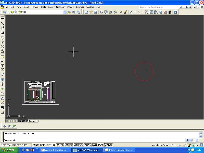

It doesn't seem to happen in AutoCAD 2009 on the same drawing.
so I won't be able to load a screen capture.
With 2007 my PDMODE was 0, and they where still there.
The "bugs " appeared to be left over from a polar snap marker/cross.
probably BLIPMODE. In 2009 turn BLIPMODE on and see if it gives you the same 'bugs' that basically mark where you have clicked until you regen.
I turned BLIPMODE on in 2009.
It didn’t leave the same marks.
But would leave some markings left behind after I would delete a line, but as soon as I would zoom in to get a closer look, the image would refresh and the lines would go away.
Before in 2007, on my new machine (they didnt appear on my old machine at all) the mystery lines would come without deleting a line, as previously posted they seemed to be the ghost of a polar snap cross/marker. and they stayed even when I zoomed in or out.

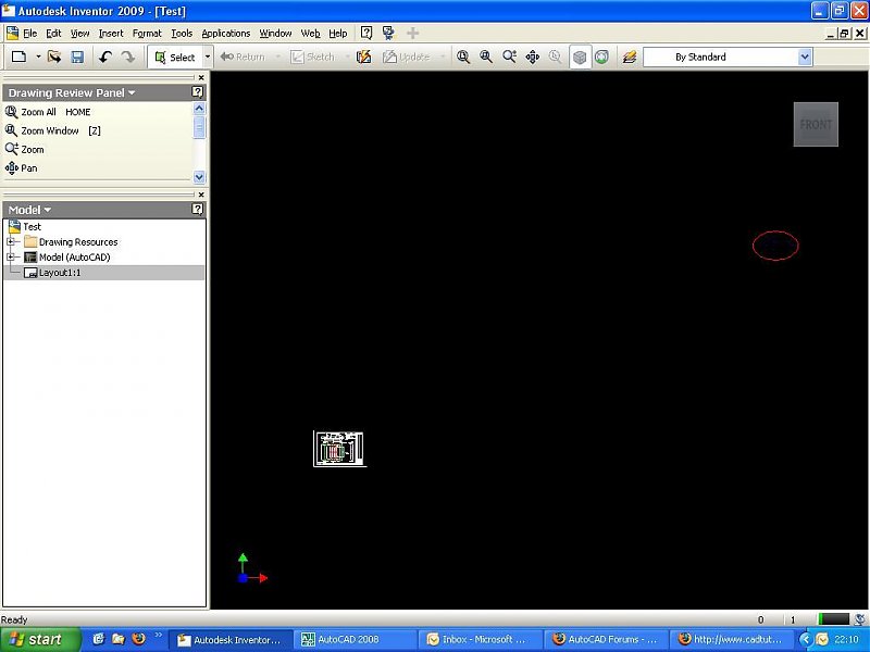

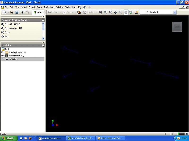

Will someone please post a file (just for fun).
I've seen this before but can't remember the cause/solution.
Here ya go, A few bugs I found
The Autocad file shows a bug in the circle red (second picture down), if you type B enter you see the blocks, however they are hidden in the drawing, I think this drawing was done in Solid Edge then exported to Autocad, we can see the blocks in Inventor as shown (as balloons)
Test.dwg
