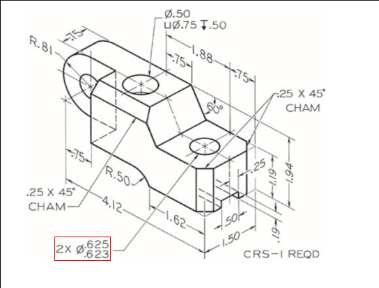

basty Posted August 30, 2023 Author Share Posted August 30, 2023 I would like to ask again. What is the pronounce of this (see attached image please in a red rectangle)? Quote Link to comment Share on other sites More sharing options...
ReMark Posted August 30, 2023 Share Posted August 30, 2023 It's a tolerance value. Tolerance is the total amount a dimension may vary and is the difference between the upper (maximum) and lower (minimum) limits. 1 Quote Link to comment Share on other sites More sharing options...
basty Posted August 31, 2023 Author Share Posted August 31, 2023 So, how do I pronounce it in English, in the technical drawing term? Quote Link to comment Share on other sites More sharing options...
BIGAL Posted August 31, 2023 Share Posted August 31, 2023 (edited) upper maximum and lower minimum diameter limits. Or 0.624 diameter with + - 0.001 tolerance. Sounds like an imperial size with a one, one thousands of an inch tolerance. 1 / 1000. Edited August 31, 2023 by BIGAL Quote Link to comment Share on other sites More sharing options...
ReMark Posted August 31, 2023 Share Posted August 31, 2023 6 hours ago, basty said: So, how do I pronounce it in English, in the technical drawing term? It is a tolerance value. Quote Link to comment Share on other sites More sharing options...
