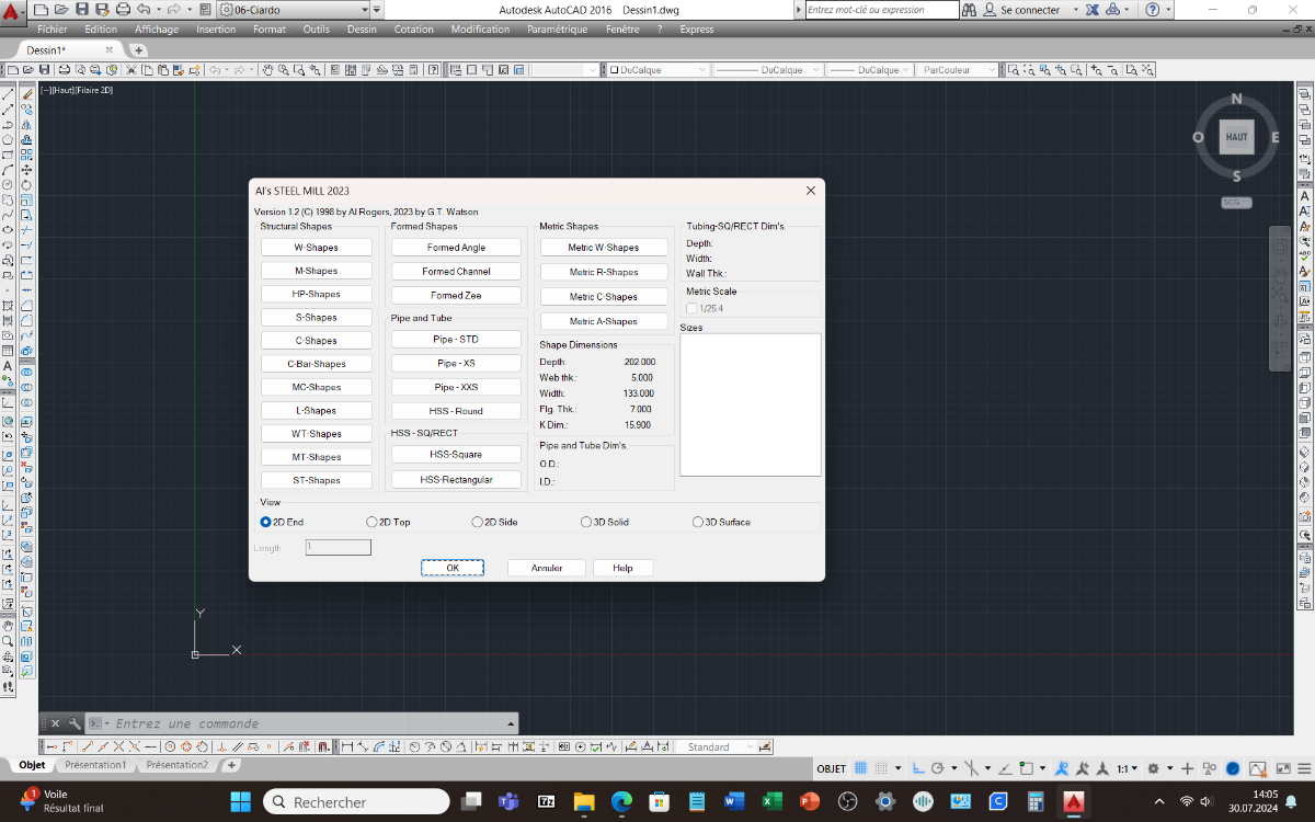

Biagio Posted July 30, 2024 Posted July 30, 2024 Bonjour SLW210 Merci pour ta réponse J’ai téléchargé cette version, voici mes print-scrine, mais il ne se passe rien Il ne dessine pas les profilées une fois choisie Peut-être que je n’ai pas compris comment faire, Eque quelqu’un peut m’aider ?? Merci d’avance. Biagio Quote
gtwatson Posted July 31, 2024 Author Posted July 31, 2024 When you unzip the files, they must be in your search path. The DCL and LSP files read the DIM files to draw the shapes. I added some more recent AISC shapes but have not looked for more since I posted the Lisp. You basically select the Shape (L, W, HP, etc) and select the view (end, top, side, solid) and select the size from the list and hit the OK and the shape will be drawn on the layer that is active. Al Rogers did 99% of the work on the Lisp and the DCL and I added some new shapes to the DIM files. I did not add anything to the metric shapes and will leave that task for someone else that does metric design and detailing. I'm a structural engineer and use this Lisp to draw shapes to scale to see if my baseplate is too close to the bolt holes or the bolts are too close to the edge. Quote

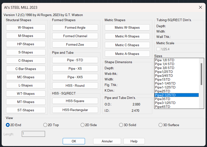

Biagio Posted August 2, 2024 Posted August 2, 2024 Merci Gtwatson, Bigal et Catoscuro Pour vos renseignements Pour Catoscuro, dommage que je n’ai pas pu ouvrir ton dessin : plaça base_1.dwg il me dit que il a été dessiné par une version plus récente, moi j’ai la 2016 de Autocad. Pour Gtwatson Bien sûr que le dossier de STL est dans le bon chemin de Autocad, là où il y a le lisp Le dcl ect. Mais je n’ai pas encore saisi la procédure, tout les points qu’il me demande. Je cherche encore Bonne journée Biagio Quote

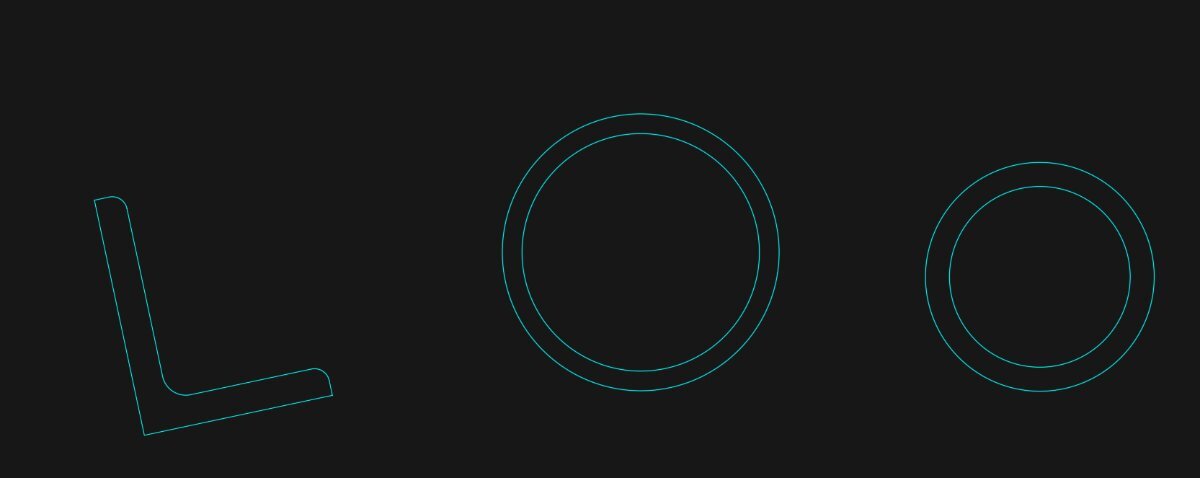

gtwatson Posted August 2, 2024 Author Posted August 2, 2024 Steps after typing STL at the prompt to start the program: 1) Select the Shape button (in your screen shot you selected Pipe-Std 2) Select the View you want (2d end etc.) 3) Select the size from the drop down Size table. 4) The OK button will now be available, and you select OK. 5) The dialog box will go away and you select a point on your drawing to start the shape. Each shape has a different starting point. 6) Doubly symmetric shapes like pipes will draw the shape 7) Singly symmetric shapes like angles will put the shape in and you can rotate it as you like dynamically. 8 ) To draw another shape, you type in STL again and repeat as needed. Quote
