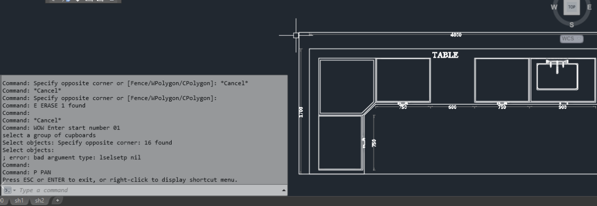

Hi @BIGAL,
I am not getting this.,

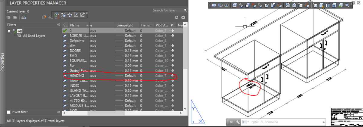

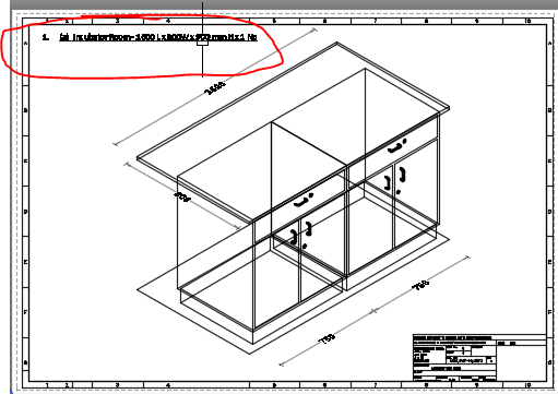

This is the output after placing text (001.png).

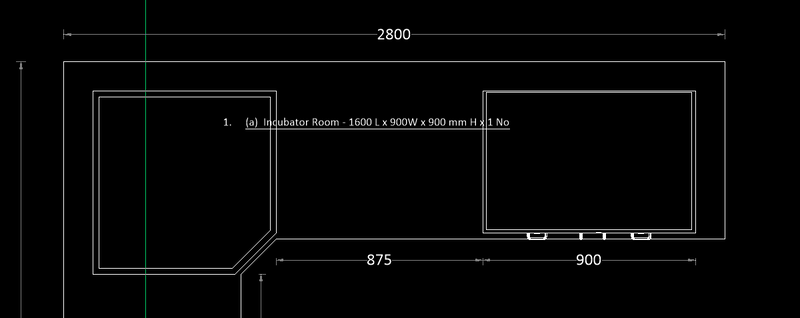

But what i am looking is like this. (002.png)
Can you explain a bit detail. Thanks

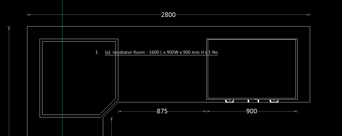

Ok a few things for it to work you have to work in UCS WORLD. The text must exist within the cupboards, I also set it to z=0
 When you select objects it also looks for the text within a new box containing all the parts.
2nd problem in new sample dwg you changed the name of the default layout I used Ph00. Can do a enter name but will leave that to you. The other option is can make layout names Ph01 Ph02 etc.

i am getting error
; error: bad argument type: lselsetp nil
where i am making mistake?

Ok a couple of rules
UCS W Plan
Make sure mtext Z is zero use properties to reset.
The master layout name is Ph00, we can discuss later different names.

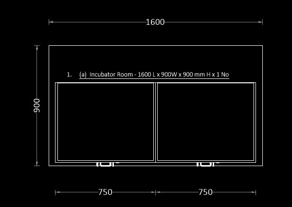

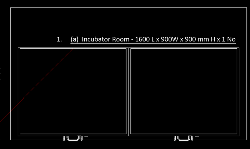

On 9/20/2023 at 4:12 AM, BIGAL said:
he text gets placed in the cupboards see image.
how to place the text in the cupboards?

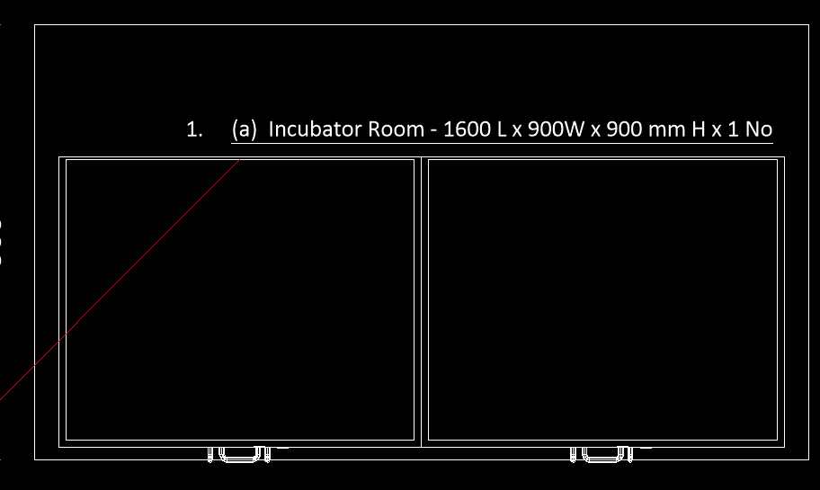

Hi @BIGAL.,
Thanks, it works in the bricscad.  not in the autocad 2015.

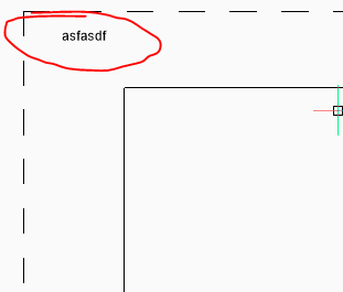

is is possible to set/ Change  the text height in the layout?
It will be the default text size and style being used in the Mtext line. Mine was using 2.5 so did not see issue but did make it do weird things to the size and style.
Look for the ctab line and add the 2 lines about setting text style and height.
(setvar 'ctab "Model")
(setvar 'textsize 2.5)
(setvar 'textstyle "Text R")
Edited by BIGAL
Hi @BIGAL,
Thanks for helping me out patiently. Appreciated.
It works. The text size has been updated.

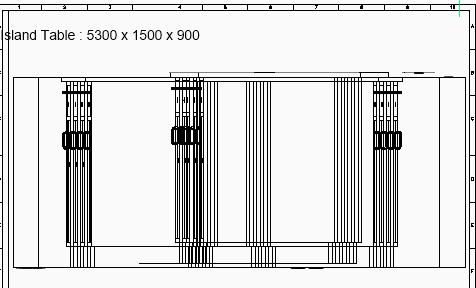

hi.,
i am getting this error some times
----- LISP : Call Stack -----
; [0]...C:WOW <<--
; ----- Error around expression -----
; (SSNAME SS2 0)
; in file :
; J:\autocad\Lisp\Layout\wow.lsp
; error : bad argument type <NIL> ; expected SELECTIONSET at [ssname]
also i am getting layout as even 3d front is selected. Attached herewith the file. am i wrong somewhere
26.09.23_01 - Copy.dwg
Edited by Sekar
adding details
I had another go at it, I have changed the view direction code I did get some problems and not sure why , seems ok with your dwg, so please download again. Dont forget you can change the function name from WOW. Download code above.
