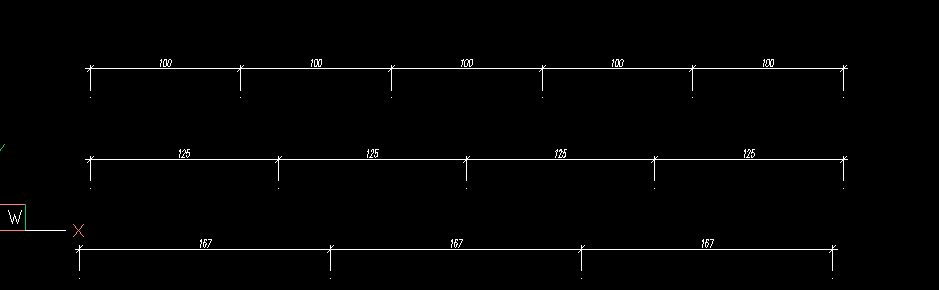

Lisp divide dimension
vanhuyou
If you look at the properties of a dimension via entget.
((-1 . <Entity name: 68b1a340>) (0 . "DIMENSION") (5 . "1A1C") (330 . <Entity name: 68b0fe80>) (100 . "AcDbEntity") (67 . 0) (410 . "Model") (8 . "0") (370 . -1) (100 . "AcDbDimension") (280 . 0) (2 . "*D13") (10 905.565830296284 -1983.72335023666 0.0) (11 -1094.43416970372 -1946.22335023666 0.0) (12 0.0 0.0 0.0) (70 . 32) (1 . "") (71 . 5) (72 . 1) (41 . 1.0) (42 . 4000.0) (73 . 0) (74 . 0) (75 . 0) (52 . 0.0) (53 . 0.0) (54 . 0.0) (51 . 0.0) (210 0.0 0.0 1.0) (3 . "B  1_20 [cm]") (100 . "AcDbAlignedDimension") (13 -3094.43416970372 -2176.25632836718 0.0) (14 905.565830296284 -2176.25632836718 0.0) (15 0.0 0.0 0.0) (16 0.0 0.0 0.0) (40 . 0.0) (50 . 0.0) (100 . "AcDbRotatedDimension"))
So look at dxf codes 13 & 14 that should be the 2 dim points so get the length divide by say 3. Dxf 10 can be used for offset point. Work out new points erase old dim and make new ones.

A freebie for you try this
(defun c:dimdiv ( / ent num pt1 pt2 pt3 pt4)
(setq ent (entget (car (entsel "\nPick dimension "))))
(setq num (getint "\nEnter how many divisons "))
(setq pt1 (cdr (assoc 13 ent)))
(setq pt2 (cdr (assoc 14 ent)))
(setq pt3 (cdr (assoc 10 ent)))
(setq dist (/ (distance pt1 pt2) num))
(setq ang (angle pt1 pt2))
(command "erase" (cdr (assoc -1 ent)) "")
(repeat num
  (setq pt4 (polar pt1 ang dist))
  (command "DIM" "align" pt1 pt4 pt3 "" "exit")
  (setq pt1 pt4)

its not dividing dimension into equal parts, please check the drawing. Thank so much man.

2 hours ago, BIGAL said:
Can some one else please check.
(defun c:dimdiv ( / *error* acdoc oldosmode oldcmdecho ent entlist num pt1 pt2 pt3 pt4 entl objl measurevalue digits rounddownvalue lsf ssl index )
  (vl-load-com)
  (setq acdoc (vla-get-ActiveDocument (vlax-get-acad-object)))
  (defun *error* ( msg )
    (if (not (wcmatch (strcase msg t) "*break,*cancel*,*exit*"))
    (setvar 'osmode oldosmode)
    (setvar 'cmdecho oldcmdecho)
    (vla-EndUndoMark acdoc)
  ;; Round Down  -  Lee Mac
  ;; Rounds 'n' down to the nearest 'm'
  (defun LM:rounddown (n m)
    ((lambda (r) (cond ((equal 0.0 r 1e-8) n) ((< n 0) (- n r m)) ((- n r))))
      (rem n m)
  (vla-StartUndoMark acdoc)
  (setq oldosmode (getvar 'osmode))
  (setq oldcmdecho (getvar 'cmdecho))
  (setvar 'cmdecho 0)
  (setvar 'osmode 0)
  (princ "\n Pick Dimension : ")
  (if (setq ss (ssget '((0 . "DIMENSION"))))
      (setq ssl (sslength ss))
      (setq index 0)
      (repeat ssl
        (setq ent (ssname ss index))
        (setq entlist (entget ent))
        (setq pt1 (cdr (assoc 13 entlist)))
        (setq pt2 (cdr (assoc 14 entlist)))
        (setq pt3 (cdr (assoc 10 entlist)))
        (setq lsf (vlax-get-property (vlax-ename->vla-object ent) 'linearscalefactor))
        (entdel ent)
        (repeat num
          (setq entl (entlast))
          (setq objl (vlax-ename->vla-object entl))
          (vlax-put-property objl 'linearscalefactor lsf)
          (setq measurevalue (vlax-get-property objl 'measurement))
          (setq digits (strlen (rtos measurevalue 2 0)))
          (setq rounddownvalue (LM:rounddown measurevalue (expt 10 (- digits 2))))
          (vlax-put-property objl 'textoverride rounddownvalue)
          (setq pt1 pt4)
        (setq index (+ index 1))
    (progn)
maybe osmode do that?
