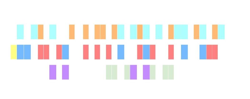

Vitalie Robu Posted September 27, 2023 Share Posted September 27, 2023 Hello, is there a way, or a LISP, to set the background color of a pattern hatch (for ex.: AR-SAND) to ByLayer or ByBlock? There is this option only for the main color of the pattern hatch, but not for the background. I want to be able to change the background color of a pattern hatch without hatch editing. For example, I have a few copies of the same block with a AR-SAND hatch where the main color is 250 and a predefined background color, and based on their position the type of block is defined. So I want to chose one type of these blocks and change the color of the background. If it would have been a SOLID hatch, that would be easy to do(please see attached screenshot), but it is different for the pattern hatch. Thanks'! Quote Link to comment Share on other sites More sharing options...
Vitalie Robu Posted September 27, 2023 Author Share Posted September 27, 2023 (edited) Just realized that one workaround to fix it is to get inside the block, remove the background for the pattern hatch (AR-SAND) and apply a second hatch SOLID which will have the option to be changed ByLayer or ByBlock. So therefore there will be 2 hatches inside the block. Let me know if there is a better way. Thanks'! Edited September 27, 2023 by Vitalie Robu Quote Link to comment Share on other sites More sharing options...
