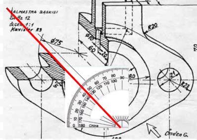

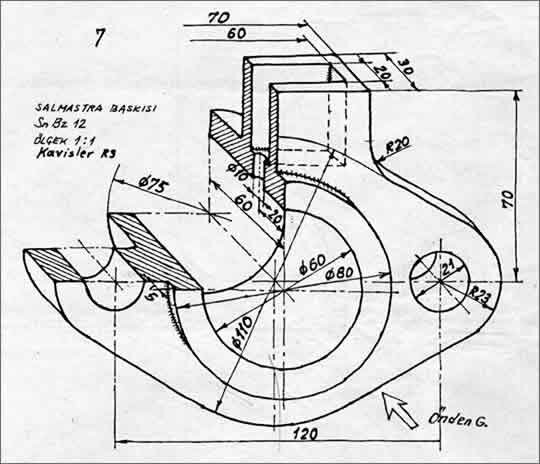

What Projection this Drawing is?
basty
The general term is an oblique projection.  It is a parallel projection but the projection lines used to create it are parallel to each other but not perpendicular to the viewing plane (as they are with an isometric drawing and other axonometric projections).  If the scale is the same in the diagonal direction as it is in the horizontal and vertical direction than it is a cavalier projection. If the third dimension is scale by 1/2 then it is referred to as a cabinet projection.
