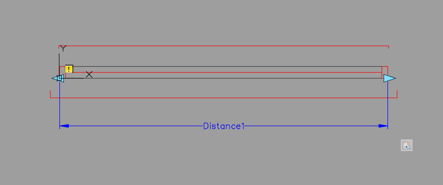

My idea is to use a lisp routine that asks me the sides of the window, when clicking on them, the block between the walls will be inserted. In every situation that I need to do this, the walls are not equal in size or angle, so I created a dynamic block with the "distance1" attribute, which can be easily moved, however I would like to know if there is a possibility of using the lisp routine to change the attribute dimension.
• This is the lisp routine:

• This is the block with the attribute

No, that's not what I'm trying to achieve.
My idea is to change the Block attribute "Distance1" to the difference between 2 sides. I'm using the BricsCAD Pro like you. Follow the video above to see what I'm trying to achieve.

1 hour ago, lastknownuser said:
(setq dist (distance side1 side2))
(setq diststr (rtos dist 2 2))
Then you just have to add distance value to block on insert, I don't use BricsCAD so not sure if inserting dynamic block works the same as AutoCad
Also check this, could be helpful:
https://www.lee-mac.com/dynamicblockfunctions.html#setdynamicprops
Hi lastknowuser,
I checked, but I couldn't do it through BricsCAD, I believe there are some differences, for example vl-some doesn't work in BricsCAD. I believe @BIGAL can have wonderful ideas.
The answer is in lee-mac dynamic functions they do work with Bricscad. You should be able to reset say distance1 and distance2 or even d2 d3 d4 for a typical 4 line wall.

(defun LM:setdynpropvalue ( blk prp val )
then
(LM:setdynpropvalue obj "Width" wid)
(LM:setdynpropvalue obj "Height" ht )
My V20 Bricscad does not have Dynamic block edit need later version. So rely on clients then do lisp etc to match.
