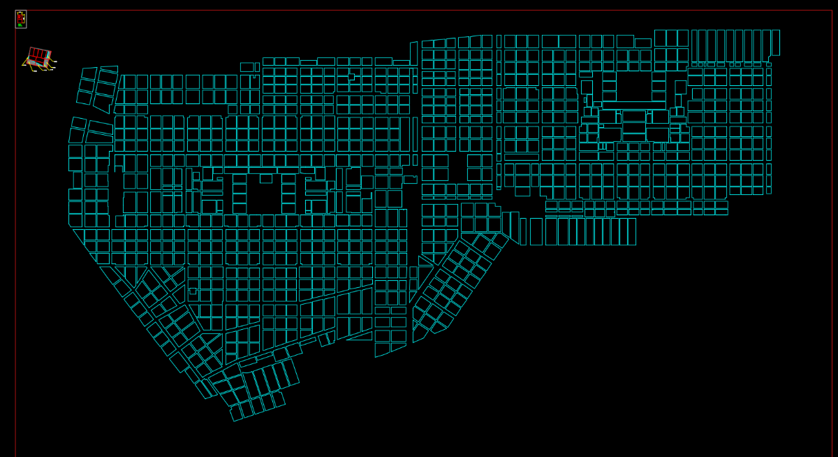

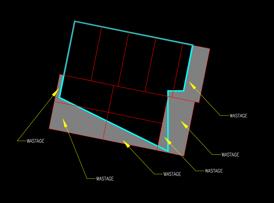

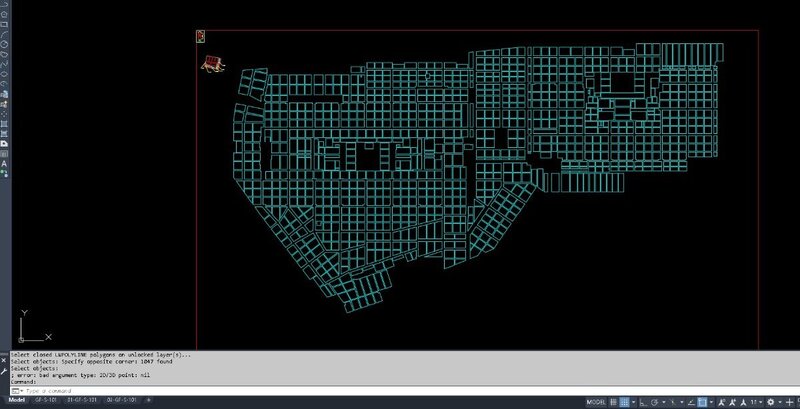

Hi Forum.

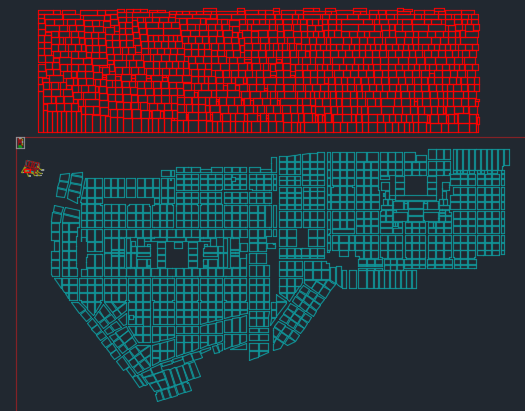

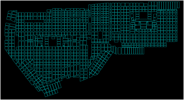

There are these set of shapes in cyan colour of various shapes and sizes.

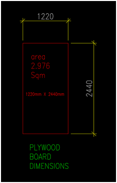

And there is a standard size Ply Wood Board of Dimensions 1220 x 2440
I need to fit this standard size in the Cyan colour shapes.
Target is to minimize wastage so as to orient and auto arrange the Standard Size ply wood Board
In all the Cyan Shape Boxes.
Something like this
Any Help would be Highly Helpfull.
Thank you.
CADSURYA
PLY WASTAGE_FORUM.dwg
Good part its mostly square. few free nesting programs out there.  https://deepnest.io/ for example. tho your going to have to number the squares so after their cut you can put them where they need to go.
--Edit
That is going to be one BIG map.

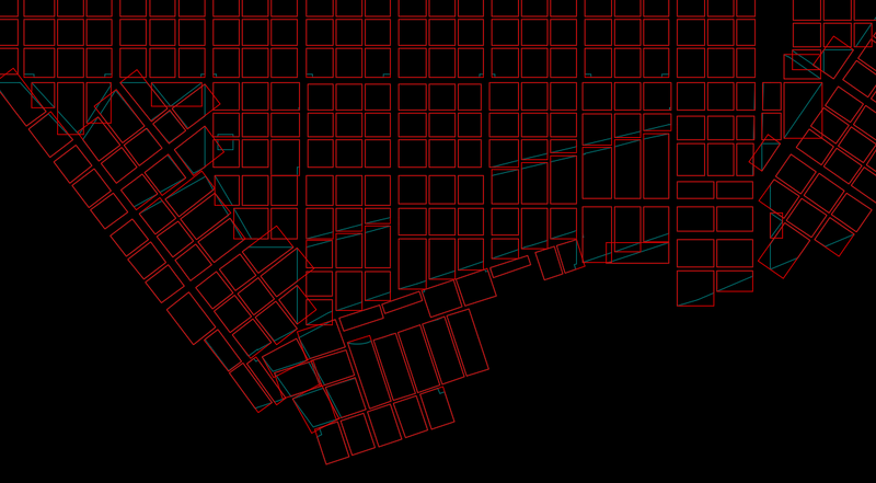

pretty hard, I can get the oriented bounding box (using python). I thought about using offset, not quite optimal
To hard for me but if numbered would it be an advantage to copy angled blocks and turn back to horizontal helping wastage problem. May help nesting speed.

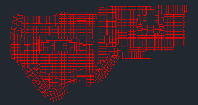

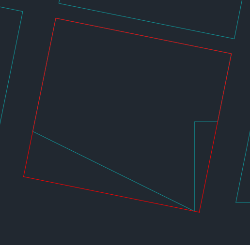

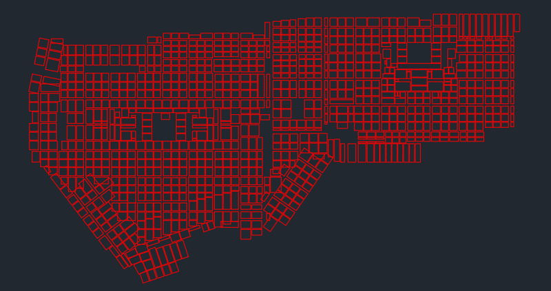

Just nesting won’t work out of the box, it’s kind of like the inverse, where the material is smaller than the part. I ran it through a nest just to see what it would look like putting the pattern over the sheets, the yield was quite bad

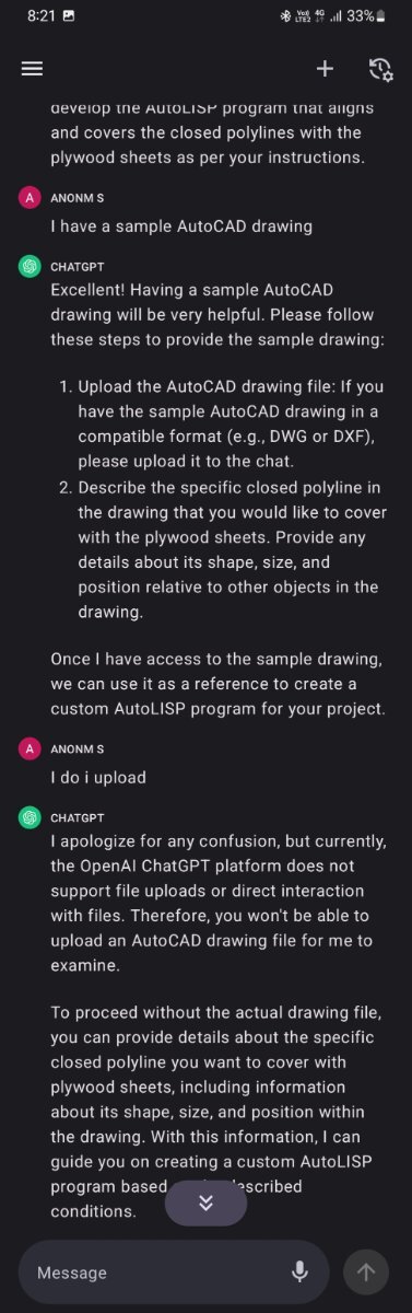

Woo!  You really got something going there Danielm103..although i don't understand LISP....
Here for the heck of it i asked chatGPT to write a AUTOlisp...
The kind of inputs it asked is appalling...

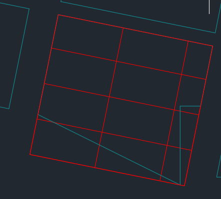

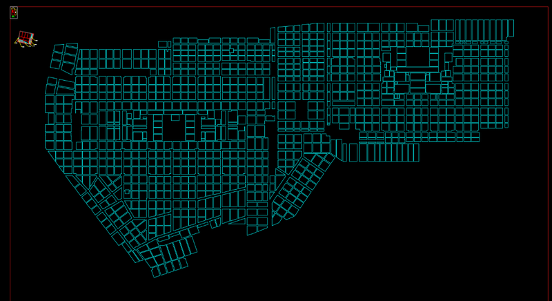

Had another play, no code if you squash your shapes so gap is saw cut thickness you can save a lot of sheets. The cost of a drafts person v's sheets not sure in this case as so many needed. I also aligned a copy of a group of sheets. Then used rectangular array.
For squashed answer maybe move sheets down a bit as top sheets are 8mm wide cut out.
There is a new post that creates a boundary around objects so using that can work out a mega sheet that is an array of sheets as the sheet size to use in the nesting process. I have a make array around an object. I created the 2nd image using some smart move functions.

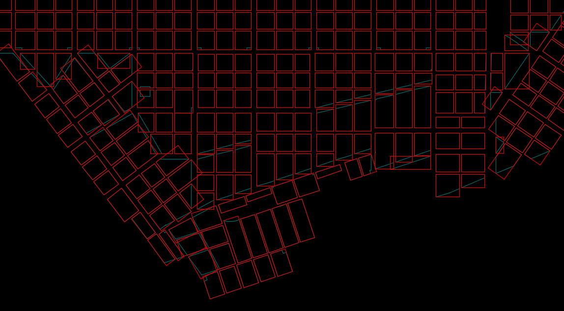

Thank you Danielm103.
That did help to visually know how many irregular shapes are then when super imposed.

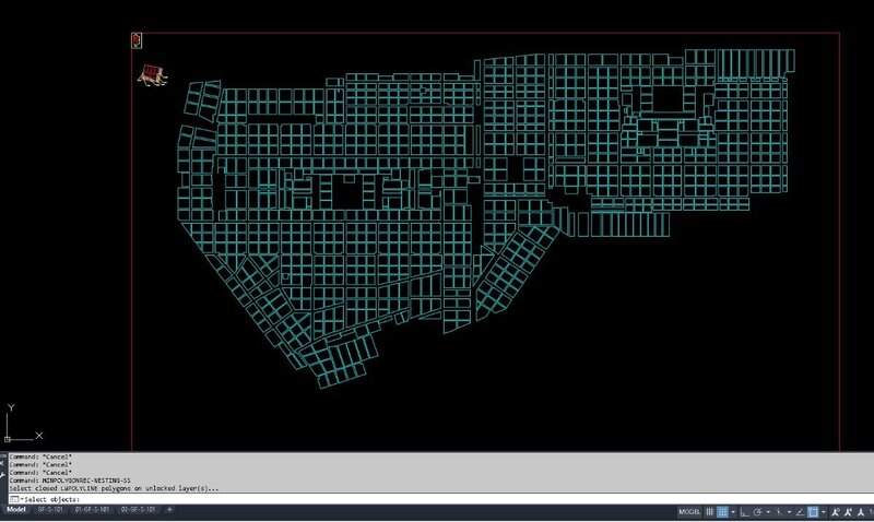

I've played with this topic too... Only problem I see is that list for analyzing is quite huge - over 1000 items... And I didn't used boundary for packing, but arranged all items in single line starting from point 0,0,0 and all up in right direction along X axis of WCS... So here is my code :
