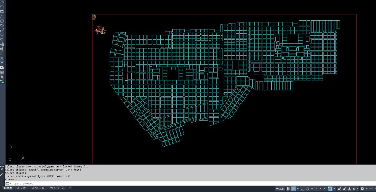

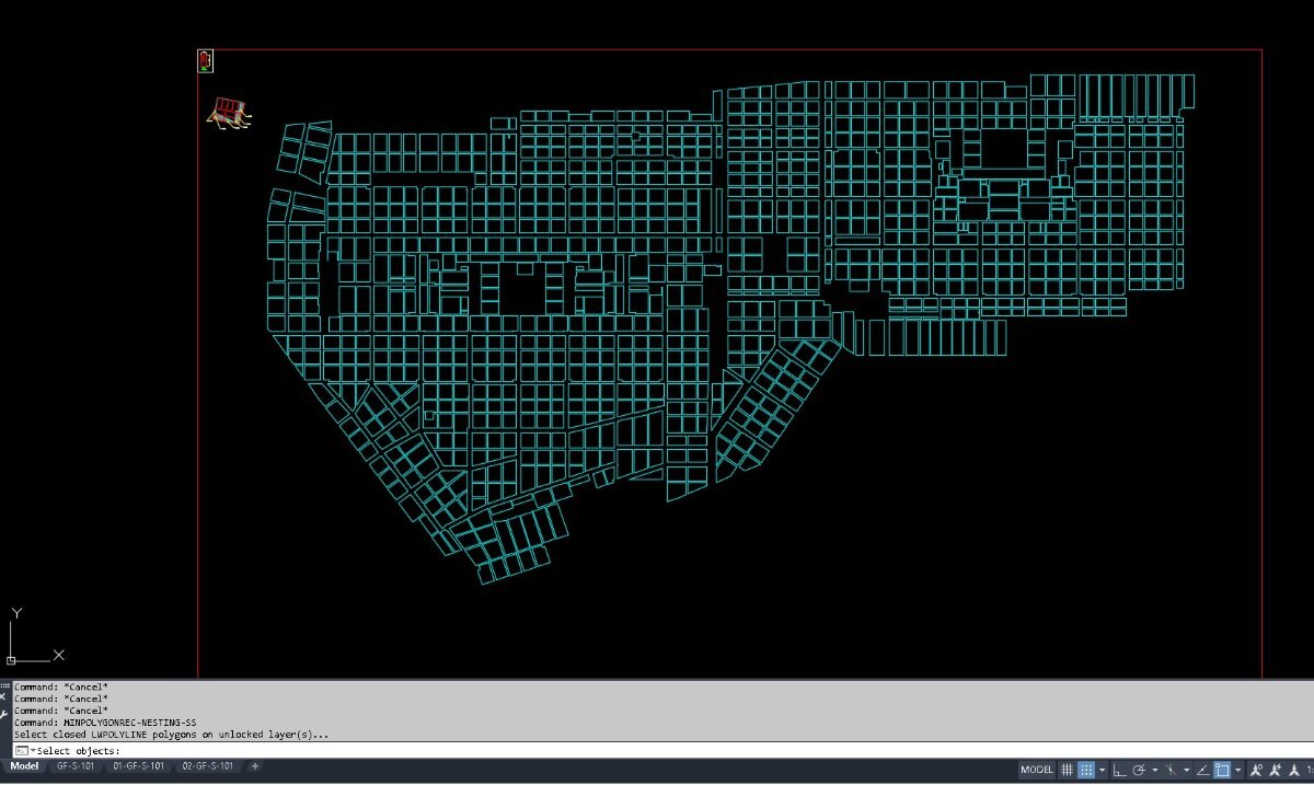

Sir marko_ribar
Thank you so much for the elaborate code. I tried it but some error is showing up.
Attached Screenshot and the file I tried it in.
all layers were unlocked before attempting to run your Code.
PLY WASTAGE CALCULATION.dwg
