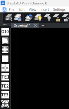

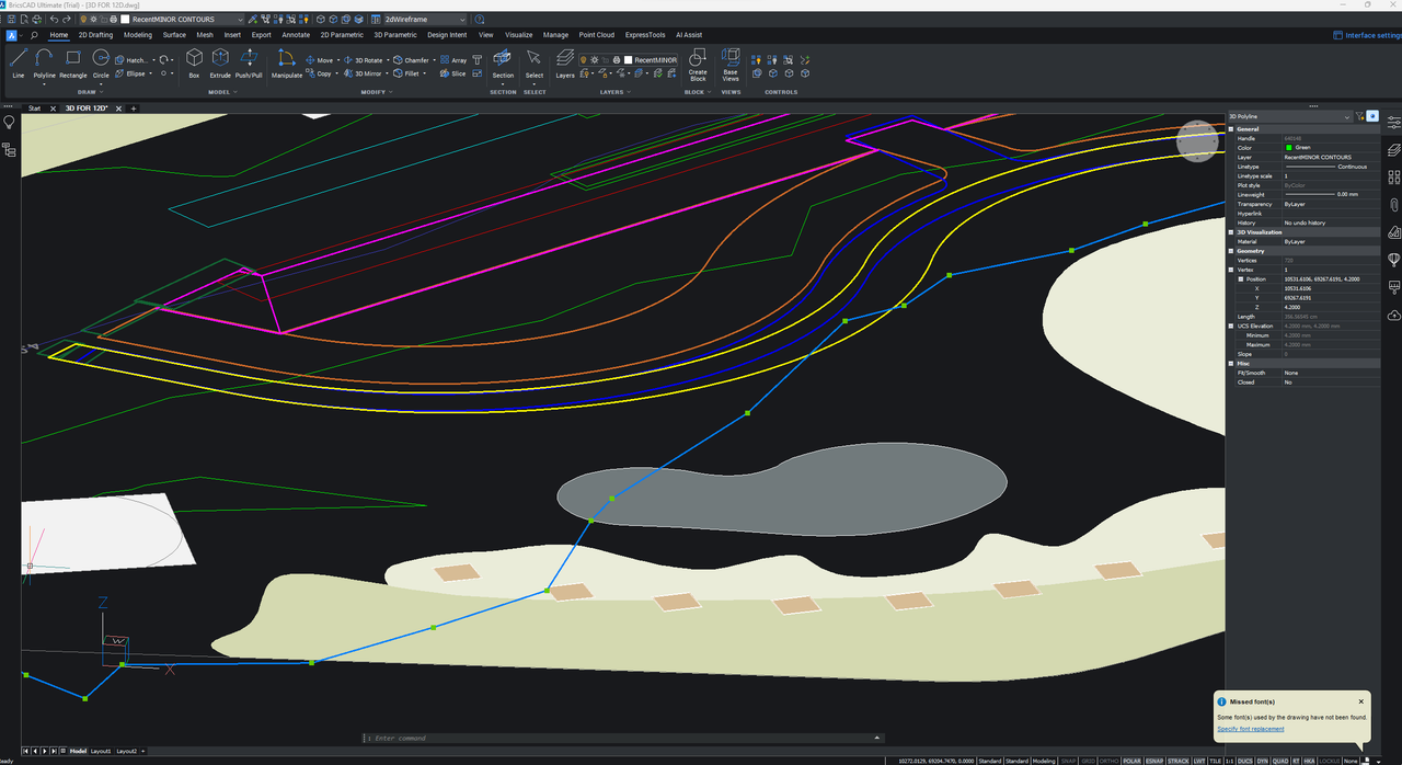

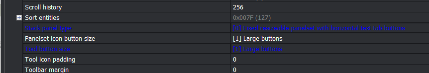

BIGAL Posted November 15, 2023 Share Posted November 15, 2023 (edited) There is somewhere about small and large icons. Set it so long ago forget. I would suggest you do a google "set large icons Bricscad" make sure use word Bricscad. It may be in the Options. This is mine see big icons. Under display. Ps I would join the Bricscad forum also, very helpful. Edited November 15, 2023 by BIGAL Quote Link to comment Share on other sites More sharing options...
