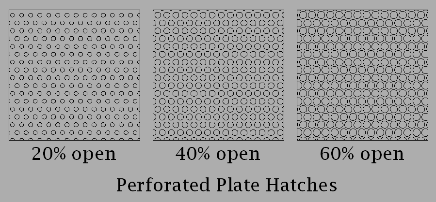

Following a suggestion in another thread, I thought to work out and calculate some hatches which simulated perforated plates with a certain percentage open.
I calculated on a unit sided hexagon for the pattern repeat, and the holes are 12 sided polygons (dodecagon) to suit, and made a spreadsheet, so that any percentage open can be easily calculated. The process is not automatic so I will not be posting the spreadsheet, but am posting three pattern files.
