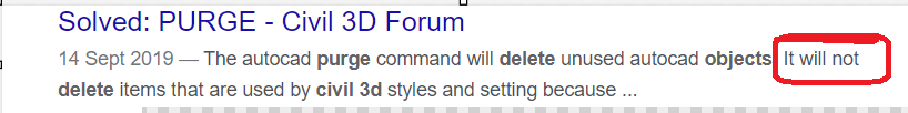

BIGAL Posted November 23, 2023 Share Posted November 23, 2023 Have you also allowed for Purging CIV3D styles it is separate to the normal purge command and should be ran before running normal PURGE. I am trying to remember I think its purgestylesandsettings. Like purge run at least twice, same with purge. 1 1 Quote Link to comment Share on other sites More sharing options...

BIGAL Posted November 23, 2023 Share Posted November 23, 2023 Mhupp CIV3D has an extra purge just for the CIV3D stuff, it removes a heap of stuff like used CIV3D styles, description keys and more, if you have a block linked to a description key and not used, normal PURGE will not remove, so you still have lots of unused blocks in your dwg. PURGESTYLES ? Quote Link to comment Share on other sites More sharing options...

BIGAL Posted November 23, 2023 Share Posted November 23, 2023 No worries I no purging the styles a couple of times then running normal purge the dwg can shrink a lot. Quote Link to comment Share on other sites More sharing options...
