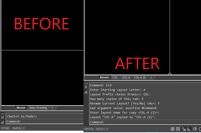

Hi,
Ever since i have updated my Gstar cad to the latest version, i am now getting this error when trying to run this LISP
; error: bad argument value: positive 0
Any idea on how to fix would be greatly appreciated as it was a huge help before when was working thanks to your excellent help!
Thank you

This is what was showing in the command line
Command: clo
Enter Starting Layout Letter: A
Layout Prefix <A4 Layou>: COL-
How many copies of this tab: 10
Rename Current Layout? [Yes/No] <No>:
Enter layout name for copy <A4 Layout (2)>:
Layout "A4 Layout" copied to "A4 Layout (2)".
Ive tried the new one you suggested but it says its successfully loaded but then says this afterwards in the command line?

@David1234 Sorry, I can't help much without a copy of GstarCAD, but tell me: does my original rewrite actually rename any of the layouts before crashing? This would help narrow down where the error is occuring.
Yes its very strange, was working great before the update!
Here is a screen shot of whats happening if that is any help?
Before its would create and rename the new layouts 'COL-A, COL-B, COL-C and so on....' for the number of copies choosen
It may have something to do with "ai" function by ElpanovEvgeniy? I don't know what that might be. Perhaps we should try and change that function to LeeMac's Increment function. I tested this in AutoCAD and it works.

      (setq cnt (1+ cnt))
(defun c:cLO (/ cnt ctb prf n)
   (setvar "tilemode" 0)
   (if (and
          (= 0 (getvar 'tilemode))
          (setq str (getstring "\nEnter Starting Layout Letter: "))
          (setq ctb (substr (getvar 'ctab) 1 (- (strlen (getvar 'ctab)) 1)))
          (setq prf (getstring (strcat "\nLayout Prefix <" ctb ">: "))
                prf (if (/= prf "") prf ctb)
          (setq n   (getint "\nHow many copies of this tab: "))
         (setq cnt 1)
         (initget "Yes No")
         (if (= (getkword "\nRename Current Layout? [Yes/No] <No>: ") "Yes")
               (command "._Layout" "_Rename" (getvar 'ctab) (strcat prf str))
               (setq cnt (1+ cnt) n (1- n))
         (repeat n
            (command "._layout" "_copy" (getvar 'ctab)
                     (strcat prf (if (> cnt 1)(setq str (numinc:incrementalpha str 1)) str))
            (setq cnt (1+ cnt))
   (c:TabSort)
;; Extracted from Lee Mac's Increment Numbering Suite:
;; https://www.lee-mac.com/numinc.html
(defun numinc:incrementalpha ( str inc / _incrementalpha a )
    (defun _incrementalpha ( a b / c d e )
        (cond
            (   (cond
                    (   (< 47 (setq c (car a)) 58)
                        (setq d 48
                              e 10
                    (   (< 64 c 91)
                        (setq d 65
                              e 26
                    (   (< 96 c 123)
                        (setq d 97
                              e 26
                (setq c (+ (- c d) b)
                      b (/ c e)
                (cons (+ d (rem c e))
                    (if (zerop b)
                        (cdr a)
                        (if (cdr a)
                            (_incrementalpha (cdr  a) b)
                            (_incrementalpha (list d) (if (= 10 e) b (1- b)))
            (   (cons c
                    (if (cdr a)
                        (_incrementalpha (list 65) (1- b))
    (vl-list->string
        (reverse
            (if (setq a (reverse (vl-string->list str)))
                (_incrementalpha a inc)
                (_incrementalpha '(65) (1- inc))
That has fixed it and back working perfectly again, i cant thank you enough!!!

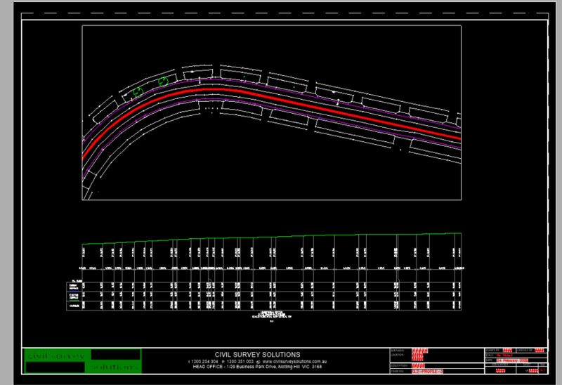

  • 2 weeks later...
Hi
Is it possible to develop program for Autolayout for Road Alignment and Profile with different Scales and Sheets Size
7 hours ago, sudheendra said:
Hi
You'll probably get better answer if you start a new thread with this one, perhaps with an example drawing showing your starting point and what you want the LISP to create.
The answer to your question is say CIV3D or for me "Civil Site Design"  just Google.
Yes does walk along alignment, road design, plot cross sections, long sections with or without plan on same sheet.
This image is from 7 sheets produced automatically.
Edited by BIGAL
But how to use in Civil Site Design. if you have link for downloading please share
Are you designing roads or just want the field survey plotted ?
If so like this rectangs are auto generated at scale following a line or pline, then can auto make layouts.
