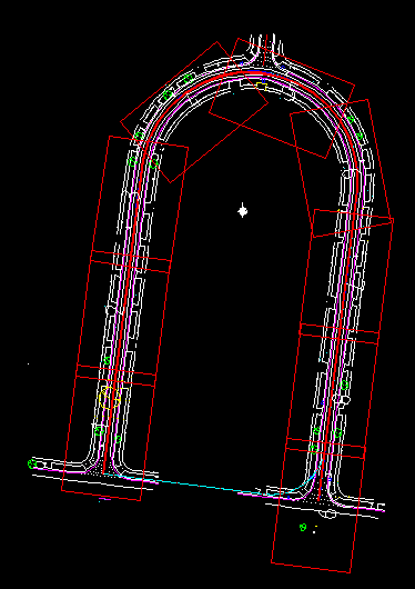

BIGAL Posted December 25, 2023 Share Posted December 25, 2023 A couple of examples, the 1st is walk along a pline and make layouts at scale. The second attached is grid based but note rectangs can be rotated. Draw rectangs.mp4 To answer your original question, do 20 layouts just use the layout command in a repeat loop. I just added the Mview to SHXX before copy much easier to just erase from 0 layout. (defun cplay ( / x num str) (setq x 0) (setq num (getint "\nHow many lyouts ? ")) (setq str (getstring "\Enter layout prefix eg EC ")) (repeat num (command "layout" "C" "SHXX" (strcat str "-" (rtos x 2 0))) (setq x (1+ x)) ) (princ) ) (cplay) If you want layouts to have a mv at chosen scale with a picked from model centre point can be done also. Quote Link to comment Share on other sites More sharing options...

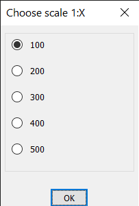

BIGAL Posted January 18 Share Posted January 18 (edited) Ok making the layouts is not a problem, choices , along pline or at point. Scale for layout is needed. Ok working out the model rectangs uses this, ((= ntitle "A1_Landscape") (setq Ht 541.0 wid 831.0 xpt 542.0 xwid 62.0 yht 32.0)) ((= ntitle "A3_Landscape") (setq ht 247.0 wid 400.0 xpt 200.0 xwid 41.0 yht 23.0)) So can add SHXXX if required, but I still think you should always use correct sheet sizes, I think the architect is shrinking the sheet to suit the size of the project not using a true sheet size then plots A3 as a FIT. So fills the mview not a good drafting practice. To get this affect would do a true A3 sheet then say draw a rectang of desired area. It would say 99% fill the mview. Edited January 18 by BIGAL Quote Link to comment Share on other sites More sharing options...

BIGAL Posted January 19 Share Posted January 19 The issue is for automation you enter name of sheet ie a layout and the scale within that layout. Quote Link to comment Share on other sites More sharing options...
Mystogan Posted January 19 Author Share Posted January 19 Yup we need to enter those need name. the most common would be 1:100 or 1:50 sometime 1:75 and A3 size landscape Quote Link to comment Share on other sites More sharing options...
