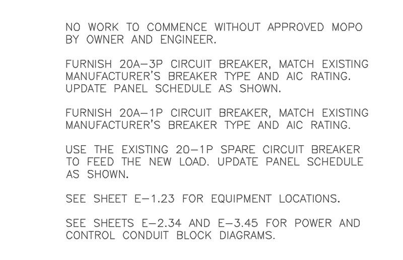

crgonzo Posted January 11 Share Posted January 11 I'm wondering if there's a method of inserting keynote symbols next to each keynote utilizing mtext formatting. I'm trying to insert the first block then have the block copy to the remaining keynotes and updating sequentially until the end. See the samples below. Thanks a bunch. Current set of notes without blocks: Desired results below: Quote Link to comment Share on other sites More sharing options...
BIGAL Posted January 11 Share Posted January 11 Ok easy 1st step ignore CAD, put your notes into Word and do the paragraph numbering, the advantage is that if you remove an item it will auto renumber, just copy and paste the Word text into mtext it should be what you want. The only thing is that I don't think you can have text in a circle. Mtext has paragraph numbering as an option also. To find each line is difficult if its mtext, may need to explode add the circle text block, using the single line text insert point. Quote Link to comment Share on other sites More sharing options...
crgonzo Posted January 11 Author Share Posted January 11 BIGAL, Thanks for response. I have tried both of those solutions. Obviously, didn't like either one. I created a routine to help but it still requires that I do extra button pushing and such. Was looking for a clever way around that but have found it difficult to find that "special" point within mtext to attach to. The initial block install is easy but the remainder requires I input the number of lines in each noted to implement the block insertion. Works well but I'm always looking for something that works better. Search continues... Quote Link to comment Share on other sites More sharing options...

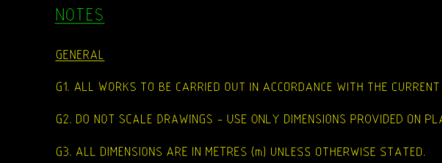

BIGAL Posted January 11 Share Posted January 11 I took a look at my notes and they have a prefix. G, D, C, S. Exploding exposes the Gx (vlax-get obj 'textstring) "G1. ALL WORKS TO BE CARRIED OUT IN ACCORDANCE So could search for any GX GXX etc taking the insertion point of that line. So copy the mtext with say Zx to right explode look for the Zx and add your block left of explode text, copy all blocks back to the left a fixed amount erase dummy text all done. So post a dwg with say notation with a prefix look at Word help. Use say Zx, use (substr txt 1 1) to look for a "Z" Quote Link to comment Share on other sites More sharing options...
