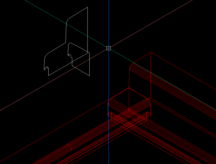

Sergio p Posted January 15 Share Posted January 15 Hello I was wondering if someone could lead me into the correct direction on how I will go about designing this is AutoCAD 2023. My work I don’t need to learn 3d modeling but I’m trying to learn myself somehow but it has been challenging. usually I just design the 2d model and cut it out on the machine but would like to learn how to get this bench so I can show the customer what it would look like in a 3d perspective. Again software I’m using is AutoCAD 2023 this is a sample of on bench I would love to learn how to draw thanks sp https://share.icloud.com/photos/0fbEmFbc6NRLuf_m8OYKBMPlw Quote Link to comment Share on other sites More sharing options...
SLW210 Posted January 15 Share Posted January 15 It seems to me Extrude the side profile would work. AutoCAD Extrude Quote Link to comment Share on other sites More sharing options...
Sergio p Posted January 15 Author Share Posted January 15 Thanks for the reply but do I draw it in 2d or 3d first. Because when I draw it in 2d and change the view and use the press pull to get the correct length I’m stuck on adding the 45 corner pull. If that makes sense Quote Link to comment Share on other sites More sharing options...
Sergio p Posted January 15 Author Share Posted January 15 Here is the actual sample I just designed if that helps Test Bench.dwg Quote Link to comment Share on other sites More sharing options...

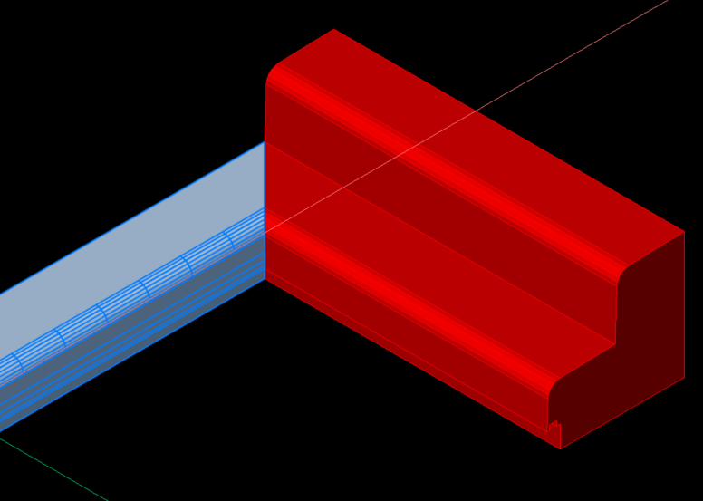

BIGAL Posted January 16 Share Posted January 16 (edited) I think maybe you need to look into extrude path, and Rotate3d the latter allows you to say stand up objects that you have drawn in plan to say now being in the Z direction. Using further solid options like SUBTRACT, UNION to build your shape. So stand your pline up move apart need 1 in X plane 1 in Y plane to get 90 corner. You probably dont need path, rather extrude a length, subtract a wedge from extruded shape then move the 2 solids to meet at mitre corner. Image has not had the wedges removed. I am no expert on solids just play around the edges, making 2 separate parts seems the way to go. Made the subract shape wrong 1st go went back and did again. Edited January 16 by BIGAL Quote Link to comment Share on other sites More sharing options...
ReMark Posted January 16 Share Posted January 16 20 hours ago, Sergio p said: Thanks for the reply but do I draw it in 2d or 3d first. Because when I draw it in 2d and change the view and use the press pull to get the correct length I’m stuck on adding the 45 corner pull. If that makes sense You could draw the profile in 2D and include a path (using the polyline command) and extrude the profile along said path. Yes, the profile would have to be rotated to a standing position before it could be extruded. 1 Quote Link to comment Share on other sites More sharing options...
