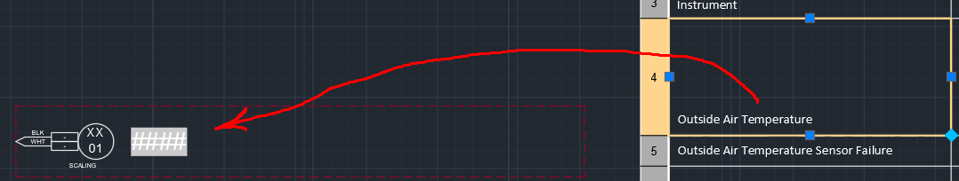

mstene Posted January 16 Share Posted January 16 I am trying to improve my workflow. In a drawing, I create a table datalinked to an excel sheet that we use to manage projects. I then have blocks representing the items from the table. Currently, I edit these attributes by hand, but have recently been finding a lot of power in the fields. Apparently, Field > Formula > Cell only allows numbers to show up in my attribute. How can I create a field that references the text of a table? Quote Link to comment Share on other sites More sharing options...

mstene Posted January 17 Author Share Posted January 17 1 hour ago, CyberAngel said: From what I can tell, you need to get an add-on (third party) package or do some coding to solve this issue. But usually someone proves me wrong. This same issue has shown up at least twice here at CADTutor (in 2010 and 2016). Plus someone who wanted to get a cell's handle. To clarify, does the same block always reference the same cell? If not, how does AutoCAD know which cell to extract for a particular instance? Yes, The idea is to set up a template, so that whatever data is linked into the table structure will get translated to the visual aspects of the block. So that if a customer wants to do a different configuration order, swapping them in the excel sheet, then reloading the data, will update the visual aspects. I can probably get away with getting a 3rd party component, but I'll fall apart when it comes to the coding part. I have an ok grasp of BASIC and bits of Python, but trying to dissect Diesel and Lisp is painful. I did see the 2016 post, and lost a little hope, but hopefully 8 years is enough time to try again. Quote Link to comment Share on other sites More sharing options...

mstene Posted January 19 Author Share Posted January 19 On 1/17/2024 at 9:06 PM, BIGAL said: Maybe go the other way, update the block attribute from excel, then use field in cell. You would need to save the handle ID in Excel of the block or maybe better the attribute. So does your Excel have the handle saved? A question how are you making the table now ? Ps no probs Acad <--> Excel for me. I think we need to see a couple of lines of your excel. If I can go directly from the excel sheet into a block's attribute, that'd be even easier. That's where I started trying to do this, but couldn't find the solution. I already knew the pathway to linkdata, so I figured that had to hold the easiest onramp into the solution. I'm not sure what you mean by the Handle ID in excel. Could you elaborate this? I think that's going to be what I'm trying to do. The excel sheet is nothing special. It's just listing out a pointlist, and then a range of cells carrying signal scaling and terminations. It's largely text, with a few numbers. Then inevitably points and instruments get changed before the project is built. So if we can update the data in excel, then refresh those fields in CAD it'll save me some revision time throughout the life of our projects. Quote Link to comment Share on other sites More sharing options...
