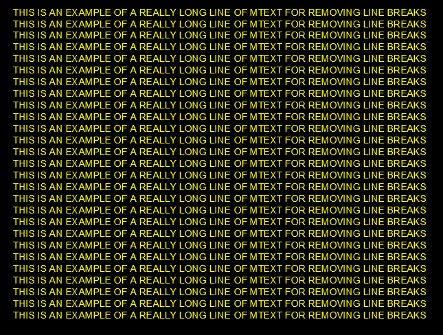

I modified a script i found so it removes linebreaks from all selected Text objects.
My problem is it only removes the first linebreak it finds. I would like it to remove all. AFAIK vl-string-subst quits after the first found instance.
I tried a loop with vl-string-search, but i'm pretty clueless.
Also i would like to have all the modified elements to remain selected.

@Highvoltage You're in luck. I just created a very similar routine for another poster. In addition to the problem with (vl-string-subst), one of other the problems with using DXF is sometimes the mtext string is separated into multiple DXF codes if the text is more than 250 chars. The additional codes use DXF code 3 instead of 1. It's better to get the full text string using ActiveX and parsing it. Try the following instead:

Thanks you all guys, you are legends.
Tried both pkenewell's and Steven P's and works great.
I had to replace "\n" to "\\P" in Steven's code, cause Autocad uses that as a line break.
After the script runs, I would like to have the selection remain. Or have a selection of the objects that has been changed in other words

@Highvoltage Here is my humble submission for adding defining the width - based on the longest line of the mtext. It may not be a perfect solution. I don't think standard mtext entered by a user would have "\n", but if this is the case I can do more parsing if needed. I also only define the width if it does not already have a width defined. I can change this as well if you would always want the width changed.
(defun c:mbch (/ _StrParse d dw obj ss tls txt wid)
   (vl-load-com)
   (vla-StartUndoMark (setq d (vla-get-activedocument (vlax-get-acad-object))))
   (defun _StrParse (str del / pos)
     (if (and str del)
        (if (setq pos (vl-string-search del str))
          (cons (substr str 1 pos) (_StrParse (substr str (+ pos 1 (strlen del))) del))
          (list str)
   (princ "\nSelect MTEXT Objects: ")
   (if (setq ss (ssget '((0 . "MTEXT"))))
      (repeat (setq n (sslength ss))
         (setq obj (vlax-ename->vla-object (ssname ss (setq n (1- n))))
               txt (vla-get-textstring obj)
               dw (vla-get-width obj)
         (if (> (length (setq tls (_strparse txt "\\P"))) 1)
            (setq txt (apply 'strcat (cons (car tls)(mapcar '(lambda (x)(strcat " " x)) (cdr tls)))))
         ;; get the width of the longest text string
         (setq wid (apply 'max (mapcar '(lambda (x / y)(setq y (textbox (list (cons 1 x))))(- (car (cadr y)) (car (car y)))) tls)))
         (vla-put-textstring obj txt)
         (if (= dw 0.0)(vla-put-width obj wid))
   (redraw)
   (vla-endundomark d)
