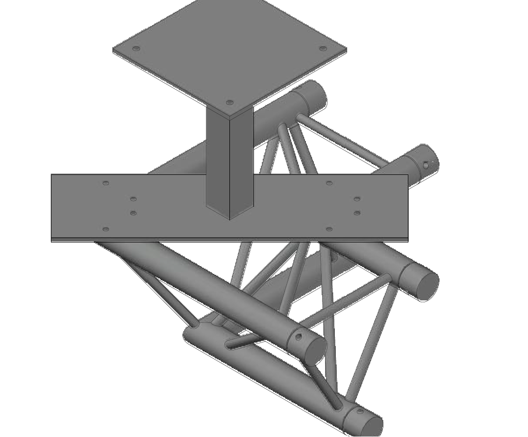

al_bey Posted January 23, 2024 Posted January 23, 2024 Hi all, hoping someone can assist. I have an issue- when creating a 3D drawing in AutoCAD 2022, the shading on diagonal lines when in paper space appears jagged, see screen shot attached. This happens when printing to pdf/ plotting and when viewing on the screen. I am using the BASE command to import the 3D Model into a template. The shading looks fine in model space in all modes on diagonal lines. Is anyone able to please assist? Many thanks Alex 1 Quote

al_bey Posted January 24, 2024 Author Posted January 24, 2024 Just as an update, this only seems to happen when using BASE command. If I plot to a new layout page using VIEWPORTS then the shading looks fine? 1 Quote

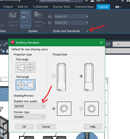

johncabahog Posted March 20, 2025 Posted March 20, 2025 Try to increase the shaded view quality. Quote
